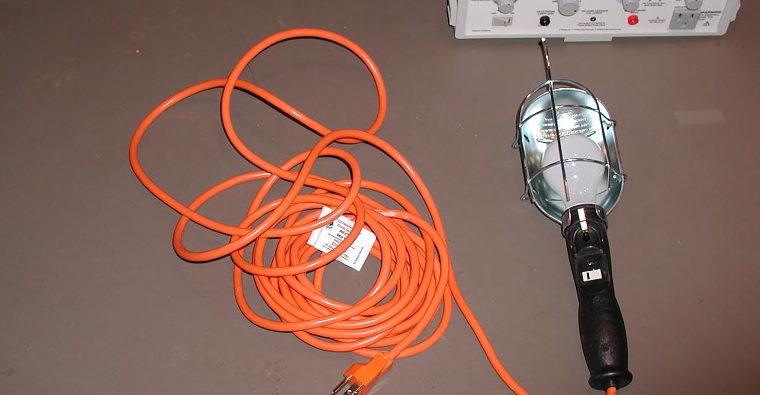

The woman's body showed no sign of trauma, but the possible cause of her death soon became apparent. Immersed in water next to her, the husband noticed the 120VAC portable hand lamp he had hung on a hook in the shower stall to provide light while he finished a home improvement project that involved installing a ceiling light fixture overhead (Photo 1). The hand lamp was plugged into a GFCI-protected bathroom receptacle via its attached 25-foot power cord, which was draped over the shower stall door.

The fact that the husband had drastically altered the scene in his efforts to assist his wife before police and medical personnel arrived made it difficult for the investigative team to piece together exactly what had happened or determine the order of events. The lamp appliance switch was in the “ON” position and the GFCI that supplied it had tripped, both of which suggested that the lamp was energized at the time of the incident. If the GFCI had tripped, though, how had the woman been electrocuted? And it was obvious that the lamp fell, but at what point and how?

The governing UL standard, UL 298, Safety for Portable Electric Hand Lamps, requires a hand lamp like the one found in the shower to withstand 1,250V for one minute in a dielectric voltage withstand test, but the sample lamp broke down in five seconds at only 400V.
After disassembling the lamp, I made clearance measurements between components and found why the lamp failed the test so quickly. The spacing between the integral receptacle's grounding lug and neutral attachment was less than 0.04-inch, significantly less than the 0.25-inch specified in UL 298 (Photo 2). To make matters worse, the grounding lug for the receptacle could move and rotate to some degree, serving to further reduce the spacing. Inspection proved the deficiency was a design defect rather than a condition caused by deterioration or use of the appliance.
In addition, a missing screw allowed for a slight separation between the two halves of the upper part of the handle, exposing the internal components to dust, dirt, debris, water, and water vapor.
Non-compliance with the leakage criteria quickly surfaced as the primary critical factor in this incident. In order to evaluate leakage current, I energized the lamp at 120VAC and monitored the resulting current flow to the lamp's grounding tab.
High ambient humidity, which would be found in a steamy bathroom like the one in question, affects ground leakage performance since water vapor can collect or condense on energized electric components and parts, which generally causes increased leakage current between inadequately spaced electrical connections or components.
In a dry state, tests found the ground leakage current of the lamp to be 25 µA, which is an acceptable value. However, when the appliance was subjected to a humid environment of 90∞F at 85% relative humidity for one-half hour — far less than the 88% relative humidity for 48 hours as specified by UL Standard 101 (incorporated by reference in UL 298) — leakage current measurements indicated the grounding circuit to be directly connected to one side of the AC line. In fact, even 40% to 50% humidity would have been enough to increase the leakage current to lethal levels.
I also tested for electric shock risk for an individual partially immersed in water with the 120VAC energized appliance immersed and in relative close proximity to the individual. With about 1 inch of water in the replica shower and with the appliance's guard in loose contact with its grounding tab, 125mA was recorded, and at 2 inches of depth, current quickly increased to about 500mA. I stopped the tests at 3 inches of depth, when current reached nearly 4,000mA. The deficient leakage performance discussed earlier confirms the high likelihood for electric shock injury to individuals coming into contact with either the appliance's metallic guard or grounding strip.
