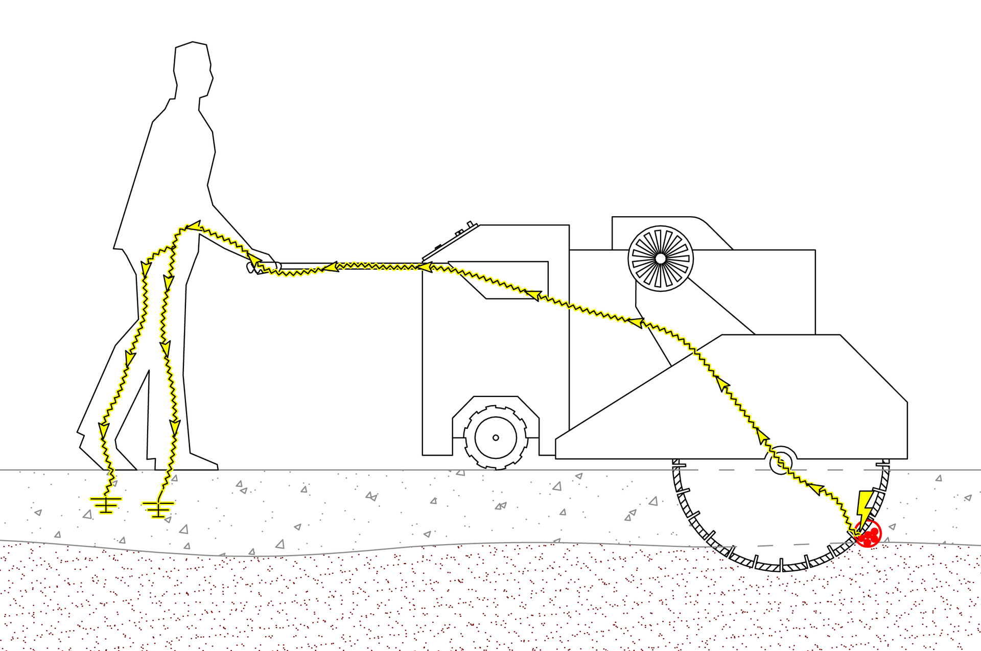

He had traveled approximately 80 ft during his first cutting pass when the arcing event occurred. After seeing a blue arc come out of the saw, he felt an electrical shock and was immediately thrown to the floor. Jared later reported that the saw itself jumped up from the cutting track due to the force of the blast.

Deposition testimony later showed that a large, 480V, 3-phase, air turnover unit located in the warehouse lost power at the time of the incident, as did some of the 120V receptacles mounted on the perimeter walls of the warehouse. The circuits originated from 480/277V and 208/120V panelboards located in an adjoining building. The circuit breakers protecting these circuits also tripped.
It is likely Jared cut through the energized conduits and conductors during the incident. Cutting through the 277V phase-neutral conductors created a fault path through the saw and/or conduit to earth. However, it also created a parallel fault path through the saw, through Jared’s left arm, and down his body to the electrical earth ground of the concrete foundation (click here to see Figure).
When the electricity traveled through Jared’s body, it affected his muscles, causing involuntary contractions. The contraction of his left arm was severe enough to tear his bicep. The shock path also likely caused his leg muscles to contract, causing him to “jump” away from the saw.
