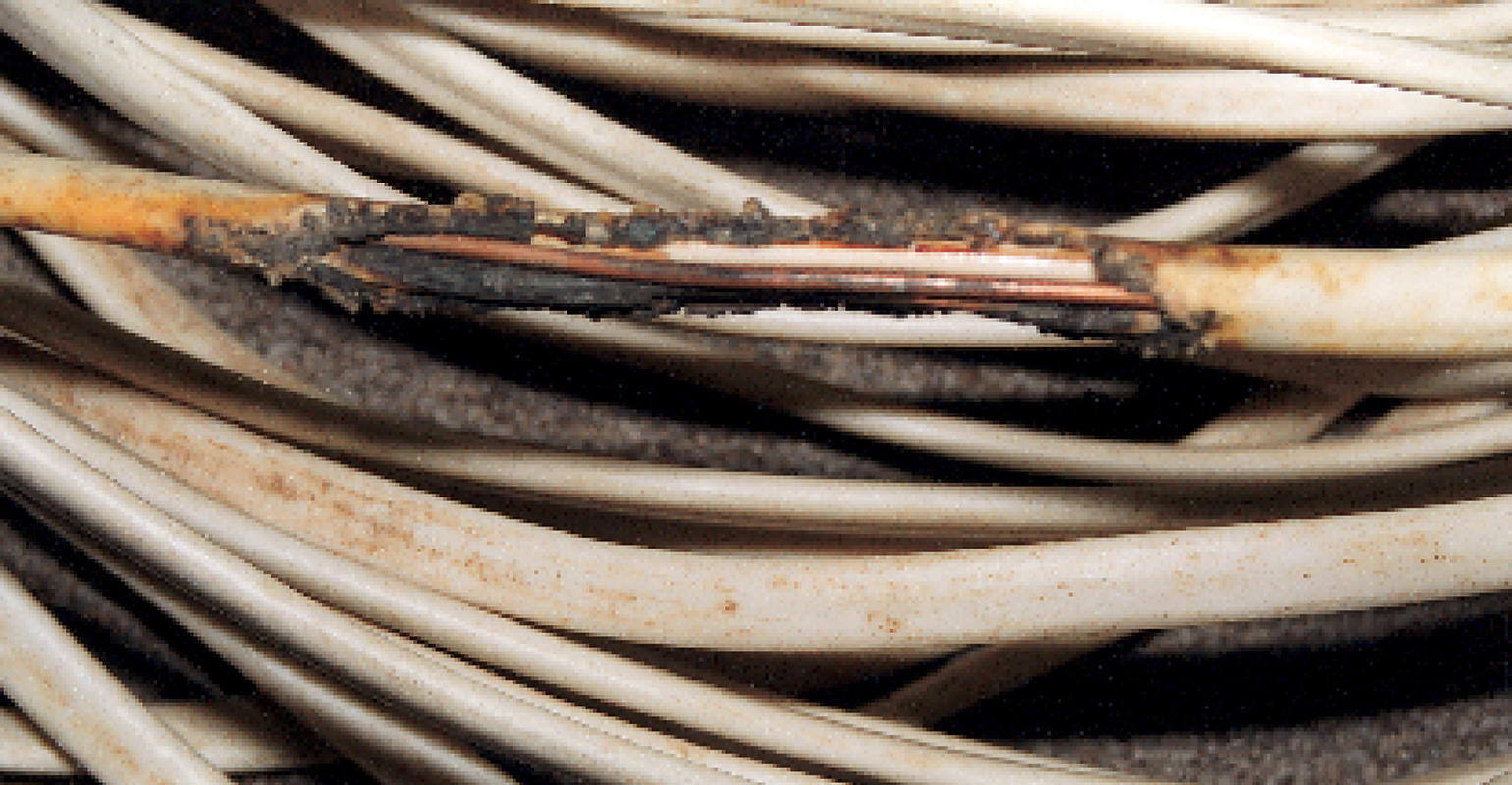

Buried cable
The carpenters buried the NM-B, 10/2 cable, with ground conductor, about 6 in. below crushed rock, which workers spread over the area to accommodate heavy construction-related truck traffic. Laboratory examination of the cable found the outer sheath torn and the insulation of the energized conductor damaged. Analysts also found localized heating at one location on the cable.
The engineer concluded the crushed rock most likely damaged the conductor insulation after its installation. Once this occurred, the energized conductor contacted the bare grounding conductor, which in turn energized the outer case of the pump. The pump case became energized because the carpenters did not effectively ground the grounding conductor at the construction panel receptacle.
