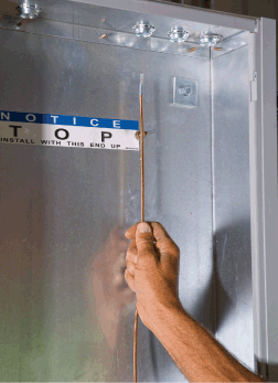

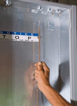

The sequence of events allegedly began when Contractor A, tasked with routing control wiring, was using a lengthy metal fish tape to try to reach from one location to another via a conduit.
After pushing drastically more tape than should have been necessary into the conduit, the facility suddenly went black.
Upon inspection, it was determined that the fish tape had exited the conduit into the dead space below the 480V distribution panel. As more tape was pushed into the space, a conductive spider web of fish tape rapidly formed. As the web expanded, it climbed higher into the dead space until contact was made between phases, causing the system to trip out.
Amazingly, no one handling the fish tape was injured, nor was there any damage to the main panel. Based on testimony from the involved parties, the workers cleaned up the mess, removed the fish tape in pieces, and re-energized the panel. No harm — no foul. If the story had ended there, there would be no Forensic Casebook for me to write. Unfortunately, that was not the case.
