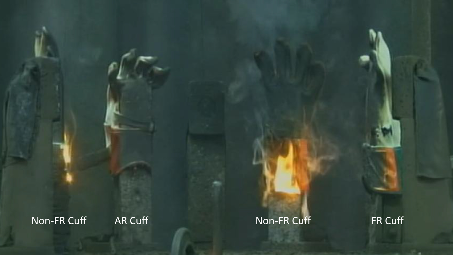

This image shows F696 gloves in which the AR Cuff also meets ASTM F3258.

With the introduction of this standard, the ASTM F18 committee will continue to drive innovation by allowing non-leather materials like para-aramids, flame-resistant threads, and other innovations to enter the marketplace with tested performance characteristics. In the process of testing, one glaring weakness was observed in ASTM F696 gloves: There was no requirement for cuff materials to be flame resistant. While there are no known incidents of ignition of glove cuffs in field use, many burned, melted, and dripped in arc flash exposures during testing. Any glove dual certified to both ASTM F696 and ASTM F3258, or certified to ASTM F696, arc-rated by ASTM F2675, and passing the ignition withstand test in F2675, will no longer have a cuff material that can ignite, melt, or continue to burn.
