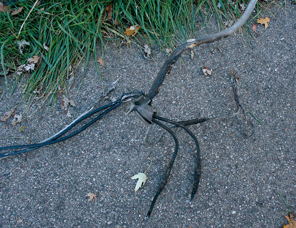

Photo 1. The service drop conductors melted and fell away from the house.
The handyman called the fire department and was put on hold three times before getting an answer. He walked outside to the front of the house and saw the window air conditioner to the bedroom engulfed in flames. He also noticed arcing in the service drop (the run of service cable between the electric utility transformer on the utility pole and the attachment point at the house) near its connection to the service entrance (the run of service cable between the attachment point on the house and the main circuit breaker or fuse panel inside the house). The homeowner characterized this arcing as “a lot of little fireworks, like sparklers” that sounded like “glasses popping.” Suddenly, the service drop conductors fell away from the house and continued to spark on the ground (Photo 1). They were still arcing when the fire department arrived.

The homeowner was certain there was no fire around the service drop when she first saw it arcing. She stated that no one in the house smoked, and there were no candles in use at the time of the fire. She also recalled that the service drop had been replaced by the electric utility three months earlier after a semi-truck struck and knocked it down. However, the homeowner was not sure whether the electric utility had replaced the entire service drop or merely re-attached the disconnected conductors to the house.

It was theorized, with some confidence, that arcing in the service cable would behave in the same manner, producing jumps in the current waveform. These jumps (step-functions) would produce very high transient voltages in the electric utility transformer, because of the transformer’s inductance. Those very high voltages would then be transferred to the wiring in the house. The household wiring is only rated for 600V. It was opined that the transient voltages from jumps in the service drop arcing current waveform rose well above this 600V level to punch through the branch circuit wirings insulation and create two separate arcing fires.
The intermittent arcing in the service cable that caused this fire was observed to continue unabated because the impedance of the utility transformer and the service drop, along with the resistance of the arc, combined to keep the primary current below what it takes to open the primary fuse. Three or four separate fires had been observed inside a residence in other such cases. It was my opinion that if electric utility transformers had secondary fuses, most service cable fires, which are 1% of total fires, would be prevented.

In summary, the latent defect in the service drop, which occurred when it was damaged by the semi-truck, produced high transient voltages that entered the house and created arcing in two widely separate branch circuit locations. The primary fuse at the utility transformer and the circuit breakers in the house were unable to react quickly enough, if at all, to prevent these two fires.
