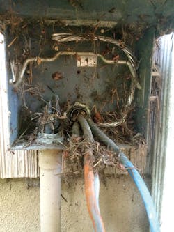

The photo, which was taken at an off-the-books renovation in Portland, Ore., shows a feeder that was partially replaced with extension cords. These were then spliced to feeder conductors that went part way, but not all the way, to the garage subpanel. Extension cords aren’t approved as a permanent wiring method, and feeder conductors were not approved to run underground. Even if they had been, they would not have been at the required burial depth (Photo courtesy of the City of Portland).

In particular, there was the large residential garage he came upon recently, which had been converted into a mother-in-law unit without a permit. Not only had the flipper jammed a water heater, electric heaters, a stove, and a handful of other appliances into a single 60A subpanel — “They needed at least 100A,” Kass says — but they’d also botched the feeder connection. “They took an old hot tub conduit, pulled the wire out, pulled the new feeder through to some point before the subpanel and spliced it,” he says. “But the feeder was too small for the last few feet, and the subpanel was irreparably damaged. It was a mess.”
Part of the same off-the-books renovation in Portland, Ore., this feeder shows the extension cord spliced to the unapproved feeder conductors that run in flex tube just under the soil surface (Photo courtesy of the City of Portland).

The makeshift replacement of the feeder running from the house was necessitated by the fact that the unapproved ADU conversion had multiple electrical appliances, including cadet wall heaters and an electric stove. The subpanel had originally been wired for 60A. The minimum required service for a dwelling is 100A. This dwelling may have required more than 100A. The result was that the old feeder burned up, as can be seen in this photo. Someone then tried to replace some of the feeder with larger conductors shown in the previous photos. Unfortunately, a conductor pathway is only as good as its weakest link; thus, replacing some but not all the feeder with a larger conductor would not have been sufficient. The service needed to be larger, along with a properly sized feeder (Photo courtesy of the City of Portland).
