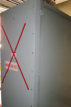

Company electricians completed the isolation of the load break switch by racking out and performing LOTO on the MV breaker in another building. They also peeled the red tape “X” off of the back of the new load break switch that had been isolated in the new substation. (This “X” is used to alert people that this part of the substation is energized. Because this load break switch had been de-energized and placed under LOTO, the “X” was removed.) Company electricians then removed the back panels of the locked-out new load break switch [36-4], and unbolted the cable terminations after verifying that the circuit parts were de-energized using voltage test equipment. At this point, they told the electrical contractor the circuit had been de-energized/locked out, and left the area. Contractor personnel placed their locks on the lock box for the circuit.

The helper promptly went up the south stairway of Bldg 12B and entered the old substation room (Fig. 2). He passed by de-energized load break switch [36-3] (which had the wires hanging out and the back taken off), noticed the door leaning up against the back wall, and continued to far load break switch [46-3] in, which was energized. He noticed that this switch was locked and tagged in the off position. He also saw the red tape “X” on this load break switch (Photo 4) but made the incorrect assumption that this device was de-energized. The helper took a battery-powered drill and removed the bolts from the back cover from the energized load break switch and placed the cover to the side. When he began to cut the cable in the back of the load break switch, he heard a loud “pop” and saw a flash. Realizing something was very wrong, he went to the south stairway to tell the contractor’s lead electrician that there might be a problem. A problem it was, indeed. Company operations personnel quickly showed up asking what had happened, considering that a significant portion of the chemical manufacturing facility had lost power when this fault occurred. Despite the disruption and downtime that followed, the miraculous thing was that the helper walked away from the incident without a scratch.
Photo 4. Red taped “X” on rear of energized load break switch 46-3.

The taped red “X” system also proved woefully inadequate as a method to inform workers of energized parts. A better system — one that is NFPA 70E-compliant — should have been used.
