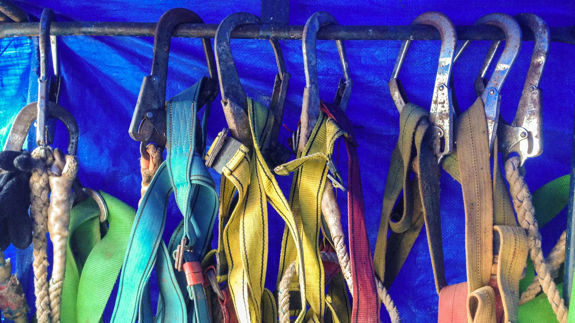

    • Assess fall protection PPE (harnesses and lanyards) for age. If it’s over 10 years old, replace it. If you don’t know the age, replace it, and start tracking the age.
    • Perform a visual inspection of fall protection PPE. If there’s any wear, stitching damage, or other signs of deterioration, replace it.
    • Ensure fall protection PPE is of the correct type for arresting a short fall. The ropes that climbers use are intended to stretch, thus softening the fall into free air. The lanyards for construction and maintenance workers are intended to not stretch because you typically do not have enough free air in which to fall.
