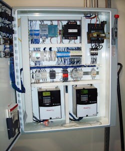

Photo 1. A group of electrical workers gathers to discuss any new technology, new types of equipment, or changes in procedures that would affect the use of safety-related work practices on this particular project.

  • New technology, new types of equipment, or changes in procedures necessitate the use of safety-related work practices that are different from those the employee would normally use (Photo 1). [Sec. 110.6(3)]
