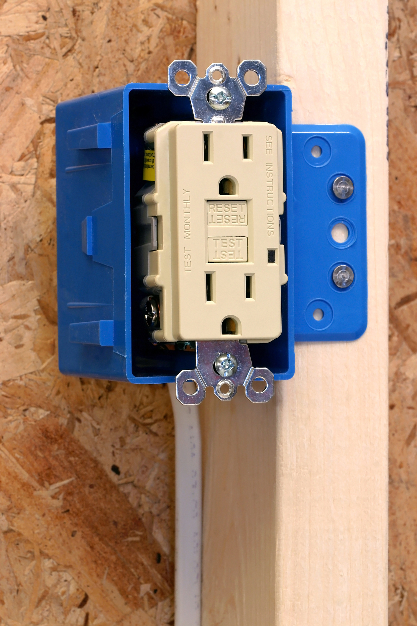

Installation of a ground-fault circuit interrupter
