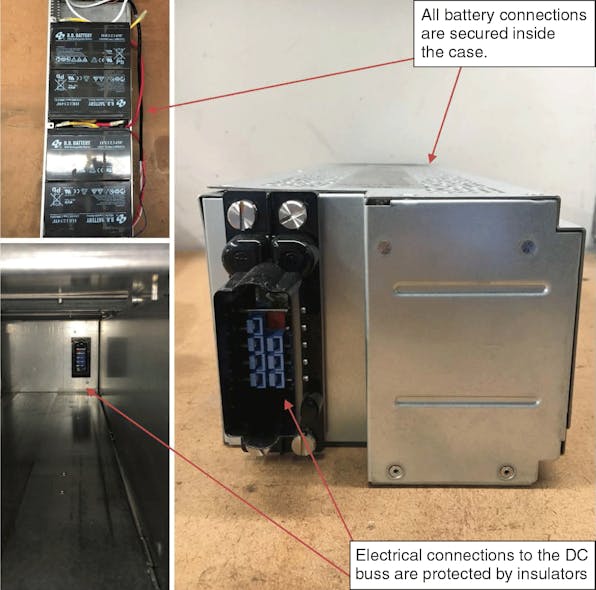

Over the last 10 years, a few manufacturers have started supplying VRLA batteries inside a container often referred to as a “battery can” or “battery module” (Fig. 4).
Modular battery systems have the same electrical dangers as open racks or battery cabinets. However, because the batteries are enclosed in a sealed box, there is no chance they can come into contact with personnel or ground. This gives a built-in safety feature during maintenance because all the battery connections are enclosed and can’t come into contact with tools or personnel.
Although modular batteries require periodic maintenance, it’s not as invasive as traditional VRLA or vented batteries. Instead of using specialized test equipment to test each jar’s voltage, internal resistance, and specific gravity, if applicable, the UPS system runs a battery test at preprogrammed dates. If a problem is found, an alarm is generated and appropriate personnel notified. This essentially eliminates risk to service personnel because there is no contact with the batteries while the system is online.
