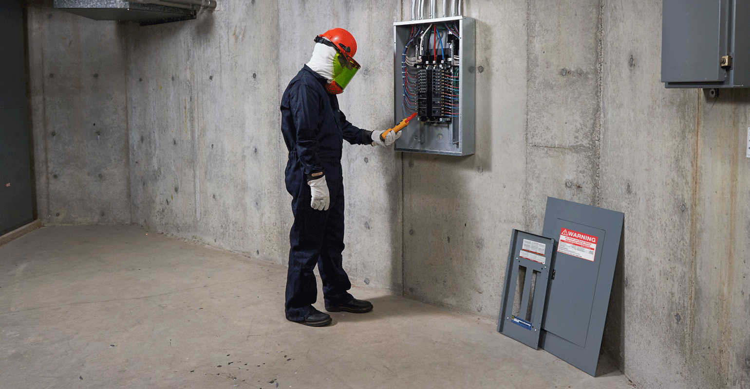

Identifying who is “qualified”
The following is OSHA’s definition of a qualified person (29CFR1910.399):
“One who has received training in and has demonstrated skills and knowledge in the construction and operation of electric equipment and installations and the hazards involved.”
Qualified persons must have:
• Skills and knowledge of the construction of the equipment they are about to work on or operate, as well as how the manufacturer recommends that equipment be operated.
• Skills and techniques to understand how the electrical system operates and the hazards associated with that equipment and system.
“Installations” refer to the type and configuration of the electrical system; main-tie-main, double-ended substation, breaker-and-a-half, ring bus, radial, etc. Each of these types of electrical systems features unique hazards workers must understand. A qualified person must receive training in and demonstrate skills and knowledge in all the above.
For qualified workers (those who are exposed or may be exposed to electrical hazards), OSHA requires the following from 29CFR1910.332(b)(3) and 1910.333:
“Qualified persons (i.e., those permitted to work on or near exposed energized parts) shall, at a minimum, be trained in and familiar with the following:”
1. Absence of voltage testing 1910.332(b)(3)(i) — “The skills and techniques necessary to distinguish exposed live parts from other parts of electric equipment.”
Interpretation: Qualified persons must be able to demonstrate the skills and techniques for performing absence of voltage testing.
2. Nominal voltage 1910.332(b)(3)(ii) — “The skills and techniques necessary to determine the nominal voltage of exposed live parts, and ….”
Interpretation: The qualified person must demonstrate the ability and knowledge to use single-line diagrams, equipment nameplates or other sources to determine what the nominal system voltage (that is, the phase-to-phase voltage) of exposed live parts, choose the appropriate test instrument and understand its limitations.
3. Approach distances 1910.332(b)(3)(iii) — “…. the clearance distances specified in 1910.333(c) and the corresponding voltages to which the qualified person will be exposed.”
Interpretation: The qualified person must understand what the shock and arc flash boundaries are and how to apply them to protect others. OSHA specifically calls out the approach boundary for shock hazards, but now that the arc flash boundary can be determined, it is included as well.
4. Safe work zone 1910.333(c)(2) — “Work on energized equipment. Only qualified persons may work on electric circuit parts or equipment that have not been de-energized under the procedures of paragraph (b) of this section. Such persons shall be capable of working safely on energized circuits and shall be familiar with the proper use of special precautionary techniques, personal protective equipment, insulating and shielding materials, and insulated tools.”
Interpretation: a) Proper use of special precautionary techniques refers to being able to set up a safe work zone around exposed energized conductors or circuit parts. The barrier or barricade would be erected at either the limited approach boundary or the arc flash boundary, whichever is farthest from the exposed energized conductors or circuit parts.
b) Use of personal protective equipment (PPE). This would include how to choose the PPE that would provide adequate protection, how to inspect it, how to wear it or use it, how to store it, how to care for it, what its testing requirements are (if any), and its limitations of use.
c) Use of insulated tools covers much of the same requirements for choosing, inspecting, storing, and limitations of use as for PPE. This is no small thing, and there must be some methodology of documenting that the qualified person demonstrated these skills successfully.
To perform the above, a qualified person must be able to interpret arc flash warning labels if a company has had an incident energy analysis performed at its site. Arc flash warning labels are covered in NFPA 70E Sec. 130.5(H). Arc flash warning labels also provide guidance on selecting the PPE required. If no arc flash warning labels are present, qualified persons must be able to select PPE based on the tables in NFPA 70E and be able to determine when the tables cannot be used. This could be because the available fault current is above that given in the tables, or if the operating time of the overcurrent protective device is too long, or if the working distance is not sufficient. Any of these conditions would require an incident energy analysis to be performed.
