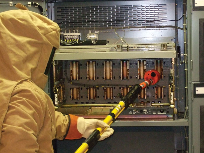

Personal protective equipment (PPE) cannot prevent an electrical incident from happening, but it can mean the difference between a survivable burn and death.

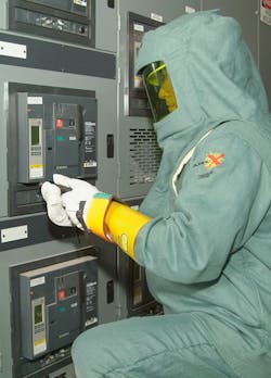

Standardizing PPE
PPE cannot prevent an electrical incident from happening, but it can mean the difference between a survivable burn and death. For that reason, it is critically important that the level of protection offered by PPE is properly understood. The new standard will likely require ratings/markings to help electrical workers understand and select high-quality PPE that is appropriate for the hazard.
Another proposed change in the 2018 edition of the NFPA 70E will introduce new requirements for conformity assessment and markings on PPE. If included in the final draft, all PPE manufacturers would be required to provide a declaration of conformity for their product(s). The compliance assessment may be conducted by a third-party organization or by the manufacturer, although the same evaluation criteria are applied in either case.
In addition, the standard will also include new PPE marking requirements. In Sec. 130.7(C)(14)(c), the standard dictates that all suppliers or manufacturers of PPE must provide the following information on or with PPE:
• Name of manufacturer.
• The product performance standards to which the product conforms.
• Arc rating where appropriate for the equipment.
• One or more identifiers such as model, serial number, lot number, or traceability code.
• Care instructions.
This information can be included on the equipment, on the smallest unit container, or within the manufacturer’s instructions, such as in the product packaging. Care instructions must be included for all clothing because some items may require special cleaning and care.
By requiring conformity assessments and proper markings for PPE, the newest edition of NFPA 70E will help standardize the market expectations for this important equipment. This will give electrical professionals added confidence in the quality of the PPE they’re using as well as help them select the right PPE for the job.
