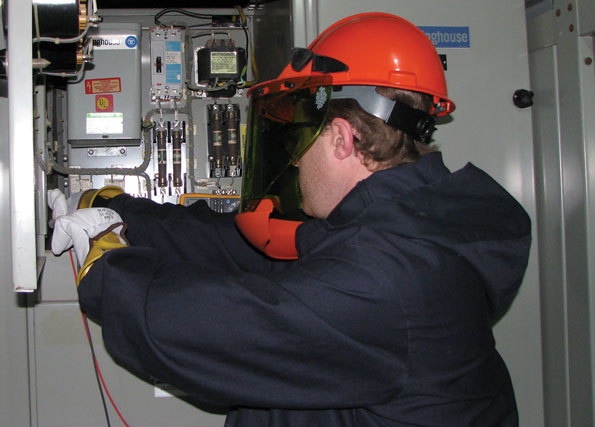

If troubleshooting, the equipment may have to be de-energized or operated to open the door to gain access. Because it is no longer “normally operating,” arc-rated clothing and PPE will be required — even to operate the overcurrent protective device to remove it from service. Refer to the arc flash risk assessment for the proper protection.
If the equipment was turned off to open the enclosure door, the equipment will need to be re-energized in order to troubleshoot it. This would also be considered operating the equipment and require the worker to wear appropriate arc-rated clothing and PPE.
Even though no EEWP is required by NFPA 70E, it may be required by your company’s safe work practices. Arc-rated clothing and PPE are always required to perform energized troubleshooting because the worker is exposed to electrical hazards.
