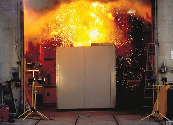

Arc-resistant switchgear — According to IEEE C37.20.7-2007, IEEE Guide for Testing Metal-Enclosed Switchgear Rated Up to 38kV for Internal Arcing Faults, use of such equipment “…is intended to provide an additional degree of protection to the personnel performing normal operating duties…under normal conditions.” Normal operating duties include opening or closing switching devices, connecting or disconnecting withdrawable parts, and/or taking readings from externally mounted monitoring equipment.
This arc-rated piece of equipment is being put to the test in the lab.
During normal operations and normal operating conditions, there is no analytical method to calculate the incident energy level within the protected perimeter of the gear, and meeting the requirements of the IEEE standard does not necessarily correspond to any particular incident energy level. What about work tasks or situations not included in “normal conditions” or “normal operating duties”? In such cases, the full calculated incident energy level would apply. As a result, there are at least two potential exposure levels, depending on the state of the equipment and the task being performed.
