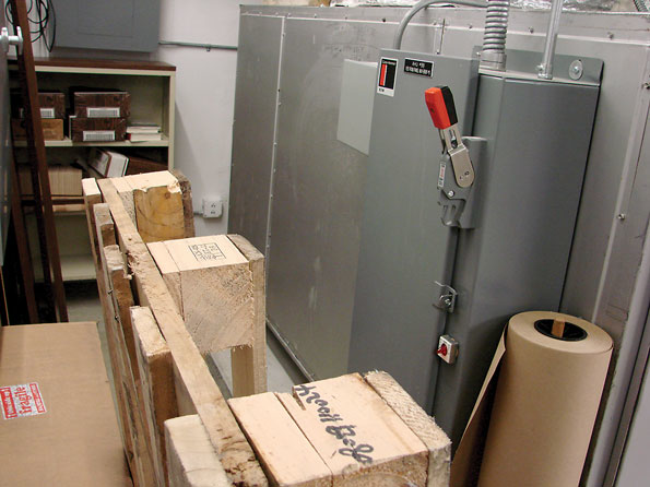

Workspace is not being kept clear, which is a violation of Sec. 110.26 of the 2014 NEC.

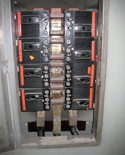

Unused openings are not effectively closed in this photo, which exposes energized parts and violates the requirements of NEC Sec. 110.12(A) and Sec. 408.7.
