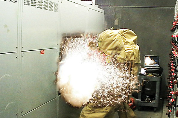

NFPA 70E — also known as the Standard for Electrical Safety in the Workplace — is the national consensus standard covering requirements for safe work practices to protect personnel by reducing exposure to major electrical hazards. It is designed to help companies and employees comply with Occupational Safety and Health Administration (OSHA) regulations and avoid workplace injuries and fatalities due to shock, electrocution, arc flash, and arc blast. Often confused, arc flash and arc blast are very different concepts. An arc flash is part of an arc fault — a type of electrical explosion that results from low-impedance connection to ground or another voltage phase in an electrical system. An arc blast is an explosive release of molten material from equipment caused by high amperage arcs.
Protecting workers from arc flash/arc blast events should be a high priority for any company.
Because working on energized equipment has become so commonplace in most industries, we must all remain vigilant in safeguarding against electrical fires, explosions, and other hazards in the facilities we service, operate, or work in. To protect against these electrical hazards, companies should not only understand the requirements of NFPA 70E, but also actively implement them as soon as possible.
