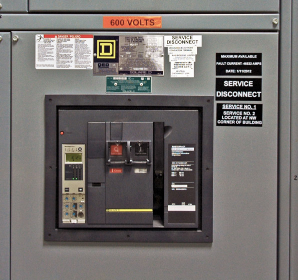

Photo 1. This image shows labels provided by the equipment manufacturer and those field marked by the installer. Note how the labels indicate system voltage and maximum fault current, as well as identify the equipment as a service disconnect. Per ANSI Z535.4, Art. 7.3 and Art. 8.1.2, informational labels like these can be made with white text on a black background or black text on a white background. Always follow the requirements of ANSI Z535 for designing your field-marked labels.
First, ensure that the maximum fault current is printed and displayed on your service disconnect. The fault current or amps interrupting capacity (AIC) rating denotes the maximum fault the breaker can interrupt without self destructing. The utility will look at the incoming potential on the primary, and then calculate what the potential is on the secondary side of its transformer. It will then publish a number that represents the maximum fault current the service should ever be able to see, and the breaker needs to be sized accordingly. Per NEC 110.24(A), this shall be field marked on the equipment (Photo 1). This particular label is not often seen on the required service equipment, because it is one of those regulations that is not commonly enforced. In addition, the service disconnect must also be labeled as the “Service Disconnect,” per NEC 230.70(B).
Per the NEC, you must also consider additional labeling if you have more than one service disconnect in your building. If so, you have to place an additional label that states the location of the other disconnect, as per NEC 230.72(A). This is critical for emergency personnel, should they need to shut down all power to the facility. Sometimes, a building requires a service that is so large the electric utility cannot supply the required power from a single set of lines. So you may end up with two individual utility feeds — usually with two separate meters.
For example, the facility might need both 120/240V and 277/480V power for larger motor loads. In some cases, these services may come in to the building at different locations. The mains for these different services must be marked to indicate where the other ones are located. A site plan of the building may show one service entering on the north side of the building and another coming in from the south. You would need to label the disconnects for these two unique services to indicate where the other one is located. If your service equipment is in a locked room or enclosure, you must also have a sign on the entrance that reads: “Danger – High Voltage – Keep Out” [see NEC 110.34(C)].

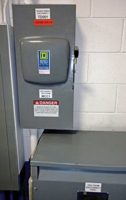

Photo 5. What's wrong with this picture? While the labeling is correct, there is a very blatant safety violation with the installation of the service disconnect feeding a separately derived system transformer in this case. The disconnect is located partially above the transformer. This installation violates Sec. 110.26 of the NEC. The depth of the transformer extends out past the front face of the disconnect, violating the clear space requirements in front of equipment that may need service while energized. Remember to always look to the codes and do not copy things that may be found pre-existing in the field.
Having the ability to prevent power loss to critical industrial automation and industrial control panels is essential to any business and important to the health and safety of those in charge of operating and maintaining such systems. The panelboards are considered branch circuits. As such, the path of power into and out of these panels is just as important as the main power, and vertical feeders and should be labeled and maintained to the highest standards possible (Photo 4).
Typically, the transfer switch is feeding into a transformer off a 480V line. NEC 450.14 indicates that transformers located in a remote location shall have a disconnecting means that is lockable, and the location shall be field marked on the transformer (Photo 5).
