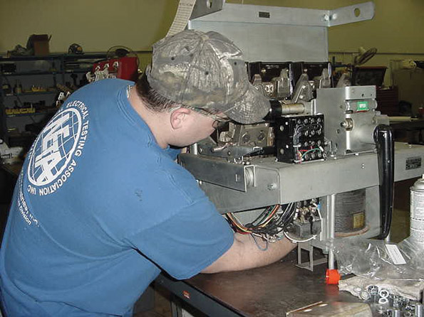

Photo 1. Will it trip, or won’t it? Without the test or calibration decal, there’s no way to tell when maintenance was last performed.

3. That Untested, Unproven Circuit Breaker Will Trip Every Time
Okay, no one would actually say that, but they certainly act like it’s true. Men, women, dogs (not sure about cats) will walk up to a circuit or piece of electrical equipment and work on it as if the circuit breaker upstream is a sure-fire bet to operate 100% in accordance with the manufacturer’s specifications. Really? I can understand the dog, but people should have a bit better recognition of the facts.
Numerous studies have shown that if circuit breakers are left in service and not operated, their chances of operating correctly get less and less with each passing year. Gary Donner with Tony Demaria Electric in Wilmington, Calif., who is a former Shell Oil Co. employee, has information on this issue first-hand. According to Donner, Shell performed a study that indicated when circuit breakers sat undisturbed for years, they would not meet manufacturers’ specifications. After three to five years of service, 30% of the circuit breakers malfunctioned. After seven to 10 years, 50% of the circuit breakers malfunctioned, and after 17 to 20 years, the number was in the high 90th percentile. Donner says that study was lost during some work site transitions and is no longer available — chalk it up to hearsay, if you like.
The Reliability Subcommittee of the IEEE Industrial and Commercial Power Systems Committee, in IEEE Standard 493 (the Gold Book), conducted a survey that included 1,469 failures of electrical equipment. Survey respondents were asked to describe their opinion of the maintenance quality in their plant. Inadequate maintenance was blamed for 16.4% of the failures. Table 5-1 in Std. 493 shows the facility’s maintenance quality vs. number of failures. It’s interesting to note that 18.1% ranked their maintenance program as “fair,” and 32.8% of the programs were ranked as “poor.” This survey included all electrical equipment, of which circuit breakers were a part. Even taking an optimistic view of that data, 25% to 30% of the maintenance for installed circuit breakers could be considered questionable (Photo 1).
In the largest survey of its kind to date, NETA-member (interNational Electrical Testing Association) companies were asked to participate in a survey on the causes of circuit breaker failures. The survey data and conclusions (340,000 results) were provided in a paper presented at the 2008 NETA PowerTest Conference. The NETA survey showed that 22% of the circuit breakers had an issue with the overcurrent protective device that would have affected its operation, and 10.5% of the circuit breakers did not function at all! Of the circuit breakers that had performance issues, 42.8% had mechanical issues — and more than half of those were related to lubrication. All three surveys point in the same direction and support each other.
Table. Maintenance intervals from NFPA 70B-2013, Recommended Practice for Electrical Equipment Maintenance, Table L.1.
How often should circuit breakers be maintained, and what should be done to them? There are two sources for answers: ANSI/NETA MTS (Maintenance Testing Specifications)-2011 and NFPA 70B-2013, “Recommended Practice for Electrical Equipment Maintenance.” Both make recommendations as to frequency and what maintenance is required of electrical devices, but the ANSI/NETA MTS also provides specifics on what the results should be. The Table is an excerpt from NFPA 70B, Annex L, “Maintenance Intervals.”
What is a reliable method to determine if the circuit breakers have been maintained? The 2013 edition of NFPA 70B, “Section 11.27 Test or Calibration Decal System,” states, “11.27.1 General. After equipment testing, device testing, or calibration, a decal on equipment, in conjunction with test records, can communicate the condition of electrical equipment to maintenance and service personnel. This can be important for assessing the hazard identification and risk assessment for electrical safety procedures as well as the condition of electrical equipment.” Suggested decals are shown in the top row of the Figure.
Figure. Test or calibration decal system as per NFPA 70B.
Bottom line: Don’t assume a piece of equipment is going to operate properly unless it’s been regularly inspected, maintained, and tested.
