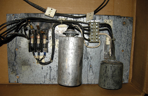

After utility personnel pulled the transformer’s primary side fusing to disconnect power, the contractor’s electricians removed the damaged surge suppressor from the switchboard along with its bus connection wiring (Photo 1). Next, they cleaned and inspected the switchboard interior. Based only on a visual examination of the equipment, they determined there was no damage to any of the switchboard’s internal components, including the bus bars, insulating parts, and visible ends of the incoming power cables.
Photo 1. Damaged surge suppressor unit removed from switchboard.
The contractor believed the suppressor had failed due to exposure to a utility-side electrical transient or “surge,” possibly due to lightning activity. However, his crew did not test the power cables between the transformer and switchboard to determine the condition of the insulation hidden from view within the underground conduits. In fact, with the compromised suppressor fully removed and all visible contaminants successfully cleaned, the contractor’s lead electrician told the school district representative on-site that the switchboard could be returned to service. He did recommend obtaining and installing a replacement suppressor at a later date, given the fact that this was potentially a long lead time assembly due to the switchboard’s age. So that Friday evening, the electric utility crew was directed to re-energize the pad-mounted transformer.
