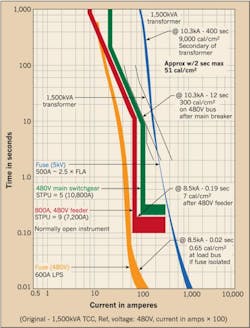

Let’s begin with a simple example of a radial portion of a distribution system (Fig. 1) having a 5kV overhead electric utility distribution line, using a pole-mounted fused disconnect, to feed an underground feeder serving an oil-filled, pad-mounted 1,500kVA transformer with 5.75% impedance. The primary full load ampacity (FLA) of the transformer is 208A. According to NEC Table 450.3(A), a primary fuse up to 300% could be used.
Let’s begin with a 500A, 5kV fuse, which is about 240% of primary FLA. There are cables connecting the 480/277V wye transformer secondary with a solidly grounded neutral to a main power circuit breaker in 480V switchgear. The secondary FLA of the transformer is 1,804A. Again, according to the NEC, a protective device could be sized up to 250% (in supervised locations), but a 125% limit (for unsupervised locations) is more common and useful for arc flash considerations. So 1.25 × 1,804A = 2,255A. However, because there is not a device of that rating, let’s begin with a 2,400A power circuit breaker. This main breaker could be set with a long time pick-up of 0.9 or 2,160A to properly protect the transformer and possibly the secondary conductors. One of the feeders from this switchgear is an 800A power circuit breaker feeding an 800A rated MCC. Finally, there is a 600A fused switch in the MCC serving a downstream panel load.
The primary conductors are routed in underground PVC conduits. The transformer primary is 100 ft of 2-250kcmil shielded copper 5kV conductors per phase with a 90°C conductor temperature — and each rated to carry 260A. The secondary conductors are routed in an underground ductbank, so you can use copper conductors with a 90°C conductor temperature using 6-500kcmil conductors per phase to carry the 1,804 FLA. However, these should be increased to 6-750kcmil per phase to carry 2,190A, which would then be protected by the secondary main breaker from a downstream fault. The conductors between the switchgear and the MCC are copper conductors with a 75°C conductor temperature in a steel conduit. Using 2-500kcmil per phase to carry 760A would allow the breaker to be set with a long time pick-up of 0.95 or 760A.
Fig. 2. Initial TCC 1,500kVA unit substation.
Once the available fault level is obtained from the electric utility, you can use the above data to evaluate the available fault levels at the switchgear and the MCC. In addition, when the equipment manufacturer and types of breakers are determined, a TCC can be prepared reflecting the operating conditions of this system (Fig. 2). Then, with the push of a button, if using commercially available software, the arc flash incident energy and arc flash boundary can be determined. But do you really have the necessary information for safe operation of the equipment at that point?

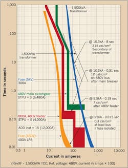

Looking back at the initial system TCC (Fig. 2), can anything be adjusted to reduce the arc flash incident energies in the system? The primary fuse could be resized. This would still allow for transformer inrush and full load capability. In general, medium-voltage fuses do not provide a real means to reduce incident energy, especially on the low-voltage side of the transformer.
For the 1,500kVA transformer with a 90MVA source, there is 12.5kA bolted fault current at 4,160V. The medium-voltage arcing fault is roughly 1% to 2% less than the bolted fault per Equation 2 of IEEE Std 1584. Then, looking at 85%, the 4,160V arcing fault level is approximately 10.6kA. A 500A fuse would respond in about 0.02 sec, yielding an arc flash energy at the transformer primary of less than 1cal/cm2. The secondary 24.3kA of bolted fault at 480V would have about 12kA of arcing fault and 10.3kA of reduced arcing fault. The medium-voltage fuses respond much too slowly, resulting in energy above 50 cal/cm2. However, looking at Fig. 7, the short-time pickup (STPU) of the secondary main could be reduced from 5 to 3. This would reduce the reaction time for the main breaker from 12 sec to 0.31 sec and thus, the arc flash incident energy from 50 cal/cm2 (for 2 sec maximum) to 12 cal/cm2. The MCC feeder STPU could be reduced from 9 to 5 to maintain coordination with the main. This would overlap the 600A fuse, but if the fuse size could be reduced to 400A, coordination would be maintained.

During this design, you could use other protective devices, such as a 2,000A secondary main fuse. When large low-voltage fuses are used, they respond in about 1 sec to a fault at seven to eight times their FLA rating and in about 0.01 sec to about 15 times their FLA rating. Keeping in mind that the arcing fault level is less than the bolted fault level (about 10kA for our example), a 2,000A secondary Class L fuse would respond to the arcing fault in about 7 sec. In fact, smaller fuses (even of the same current rating) of different types have differing responses at various current levels.
Various breaker types
Breakers also have differing characteristics. For example, an 800A adjustable power circuit breaker and an 800A thermal magnetic breaker are quite different. The power circuit breaker has long time (LTPU & LTD), short time (STPU & STD), and instantaneous (INST) settings, as well as, I2t and zone selective interlock options. The thermal magnetic breaker typically has LTPU and INST settings with possible adjustment of the INST (5 to 10 or some similar range) and possible zone selective interlock option.
It should be noted, with experience, that 480V equipment reaction times over approximately 0.5 sec for bolted fault values above 42kA — and reaction times of 1 sec for bolted fault values above 22kA — result in PPE Class 4 protective clothing level or higher.
