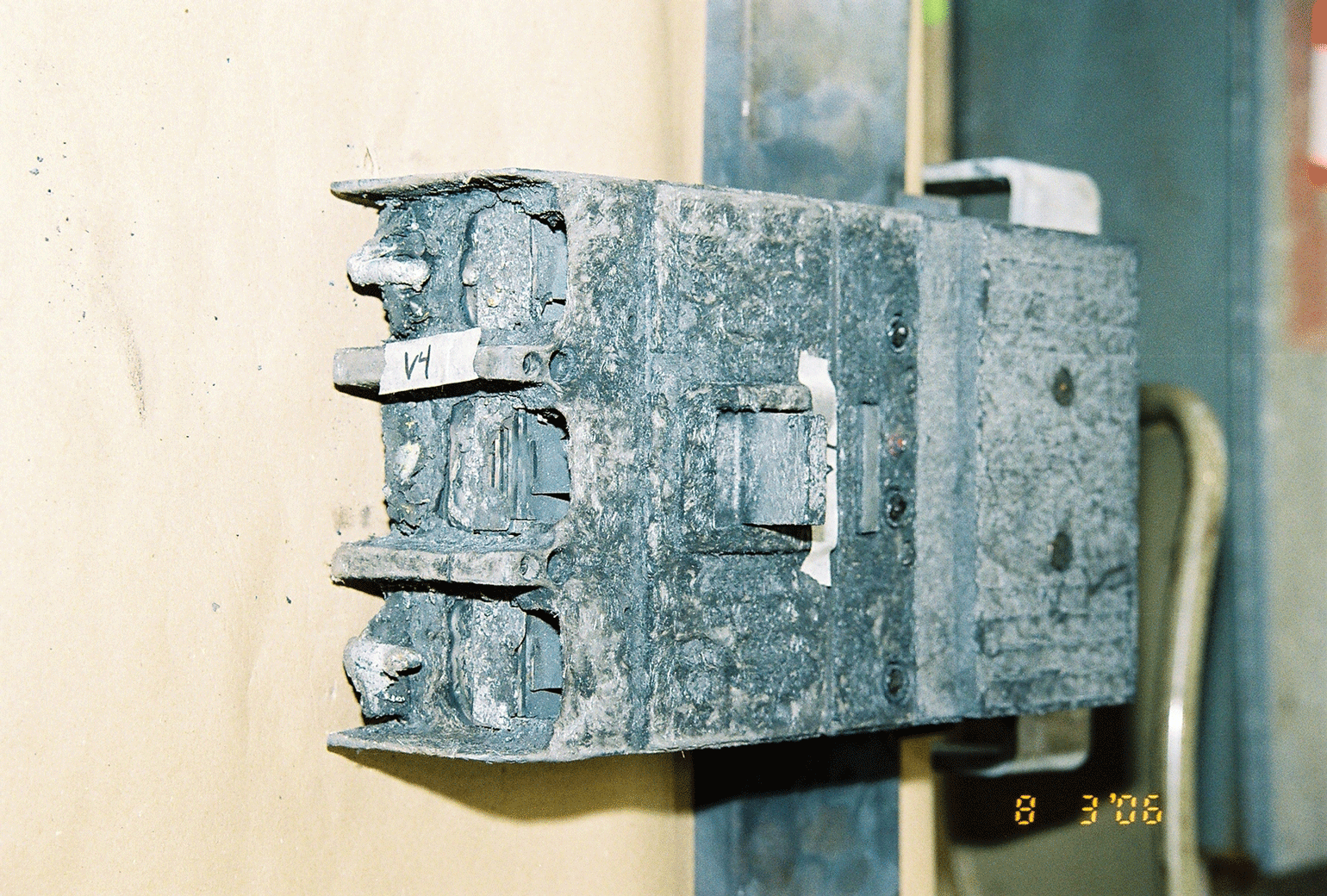

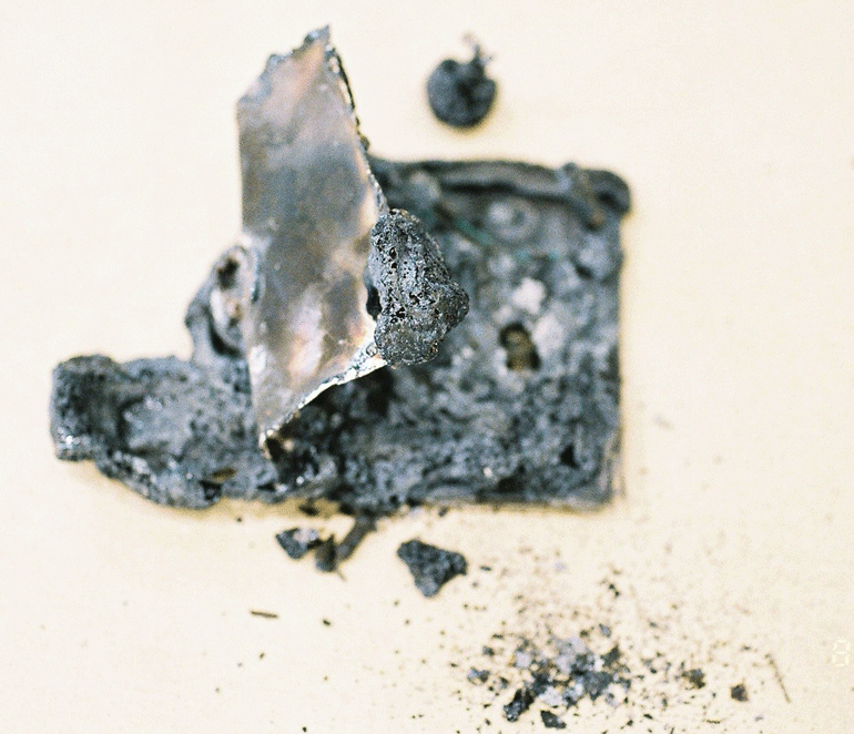

Circuit breakerPhoto 1 and Photo 2 show the damaged circuit breaker and bus bars. The line side copper lugs and bars vaporized several inches away from the breaker body. The ends of the bus bars show the typical symmetrical melting pattern from a full 3-phase arc fault. This is generally the result when a small arc occurs, and the hot conductive plasma spreads across the bars, involving all three phases. X-rays of the breaker showed no internal flaws or damage.

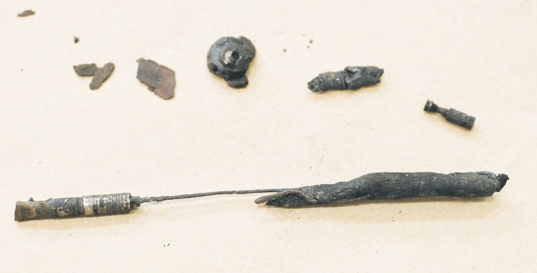

Multimeter — The multimeter was the subject of considerable investigation. It was an analog instrument designed to measure up to 1,000V, advertised on the box as an “industrial multimeter.” It did not have an International Electrotechnical Commission (IEC) safety rating, although that rating system was well accepted at the time of the accident. Meters used for 480V industrial work require a minimum IEC 600V CAT III rating. The test criteria for this rating would ensure that the instrument could withstand a 6,000V impulse with 3,000A of available short-circuit current. An engineer from the manufacturer testified that his firm had never tested that model instrument at the IEC test conditions — or even at its maximum working voltage rating.
Photo 3 shows the remains of the incident meter after the accident. The metal scale plate is bent well over 90° from its normal flat position, indicating a severe force from behind. While most of the meter housing is present in a charred form, one corner behind the scale plate is missing completely — a fuse and fuse clips are also absent from that corner.
We obtained an identical exemplar meter for study and comparison. Evaluation of the meter circuit showed that it used a small glass 8AG fuse rated 0.5A at 250V for circuit protection on some functions. According to Underwriters Laboratories, the interrupting capacity of this style of fuse is only 35A at 250V. It has no specified interrupting rating above 250V. An estimate of the fault current through the meter shows that it could have been from several hundred to as much as 1,000A at 277V.
Several locations on the meter circuit board had opposite polarity traces that were much closer than allowed by the 600V CAT III specifications. Arcing across these locations could put current through the fuse circuit.

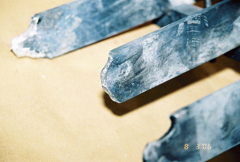

Photo 4 shows the black test probe. The base of an accessory alligator clip is still present on the probe tip. The clip itself melted due to heavy current and arcing. The red probe was not as severely damaged. In all likelihood, the red probe was grounded, and the black one was connected at the breaker lugs.

Sequence of events — The meter suffered an internal failure, most likely due to a voltage transient. Because of the severe damage to the meter and circuit board, it was not possible to determine the precise failure. However, based on the evidence, I concluded that, as a result, the fuse attempted to open the circuit against a fault current and voltage that were far above its design capability. This caused it to arc and ultimately explode, which explains the bent scale plate, housing damage, and missing fuse and clips.
