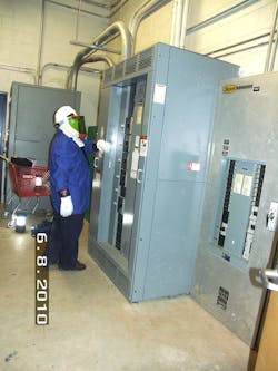

The electrician proceeded to change out the ballasts. He did not switch the circuit breaker off prior to doing so because these units had plug-type disconnects that allow you to swap them out “hot.” After changing out the first ballast, the electrician checked the connection and voltage level at the 20A circuit breaker in the 277/480VAC lighting panel. He removed his tool belt and the panel cover, placing his clamp-on meter on the panel enclosure, which was located about 10 ft from the front door. He bent down in front of the panel, preparing to perform a visual examination when he heard the door open. The next thing he knew something was falling toward him.

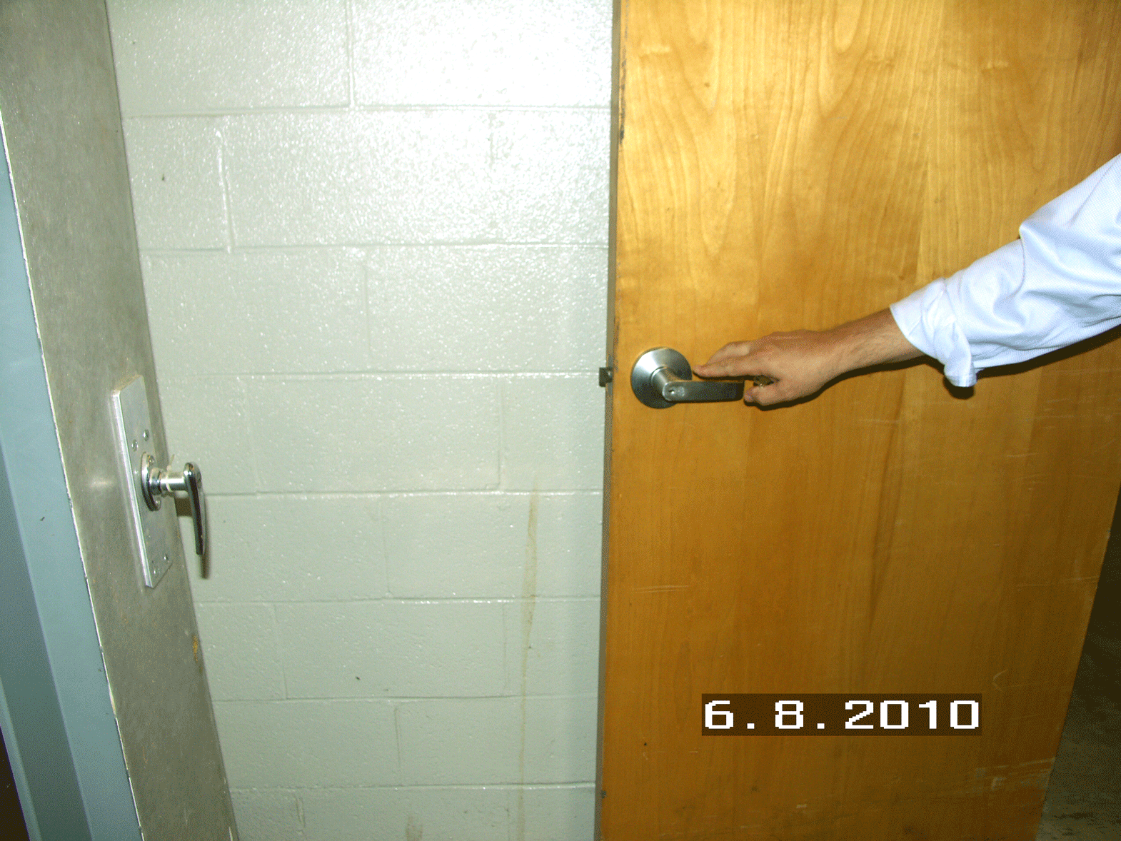

Although he hadn’t noticed it upon entering the room initially, there was a shelving unit situated behind the door that held many storage items — one of which was a chain saw resting on the top shelf. As shown in Photo 1, notice how the door swings inward. Due to the substantial weight of the chain saw, the structure’s center of gravity produced a downward tipping force when it was hit by the opening door.

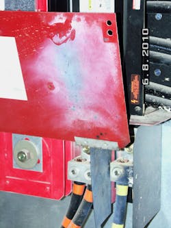

Reflexively, the electrician raised his right arm to protect his head when he saw the falling objects. The next thing he remembered he was sitting up against the panel cover, which was propped up by the main distribution cabinet (Photo 2). As shown in Photo 3, the chain saw struck the right bottom phase lug, resulting in arc flash damage to the red shield. The arc blast was heard in all offices.

At my initial site visit, I was accompanied by the electrician, his attorney, the defense attorney, employees of the electrician’s previous employer, and the store manager. The electrician’s former employer had an electrician with him who wore full PPE when removing the lighting panel cover and dead front, which covers exposed wiring to the breakers. After he finished removing the covers, the 200A circuit breaker feeding the lighting panel was turned off. We were told we were not allowed to approach within 5 ft of the panel while it was energized.
Now that the panel was de-energized, we asked the other parties to leave the room. This left me, the electrician, and the lawyer. Once the other parties had vacated, I asked the electrician to place his clamp-on meter where it was at the time of the accident and show me where and how he was positioned. Working with this information, I could establish a theory of how the chain saw fell and was ultimately deflected by his right arm into the panel. This would have put the impact point area at the bottom of the panel, which was the feeder location.
After lifting the arc shield, I could see the orientation of cables at the bottom of the panel. I was also able to match up the damage to the chain saw to the panel. Given the amount of smoke char to the back of the shield, I concluded the chain saw fault was between the line and ground. This placed the electrician about 2 ft to 3 ft in front of the arc flash location.

Despite these conclusions, one question remained: Who opened the door? The electrician was able to recall a familiar-looking woman opening the door prior to the impact; however, deposition testimony did not reveal the responsible party. There were several women working in adjacent offices who were aware someone was working in the electrical room. My working theory was that one of these women opened the door to check on the electrician or see what was going on. In the process of doing so, the door struck the shelf, causing the unit to tip over and launching the chain saw toward the victim.
