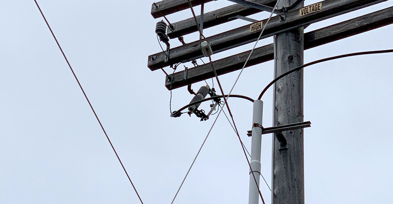

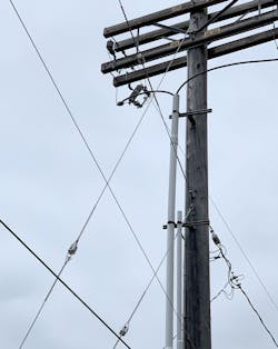

Guy wires are a key design component in the proper support of utility distribution poles.

An investigation revealed that one phase of the 3-phase distribution line atop the pole had become disconnected from the power pole and dropped down on top of the guy wire in such a way as to energize the guy wire to 7.2kV right above the porcelain strain insulator.

What stands out most in this case is that the guy wire insulator was at a level where the decedent could stay in his work zone and still easily contact the guy wire segment above the insulator. While each side can argue the negligence of the other, there is no question that had the insulator been placed higher on the guy wire, beyond the reach of the decedent, no shock would have occurred.
At the end of the day, it comes down to the little details. Power companies have a duty to inspect and maintain the safety of their facilities. On an unknown number of inspections over the life of this pole, the incorrect placement of the insulator in the guy wire was never observed and corrected. Per the testimony of other experts, this insulator was placed in the wrong position, which was an NESC violation due to the fact that it did not provide adequate and safe clearance with the lower lines. The result was the death of a telecom worker doing his job as he would have continued to do but for a fatal flaw that existed.
