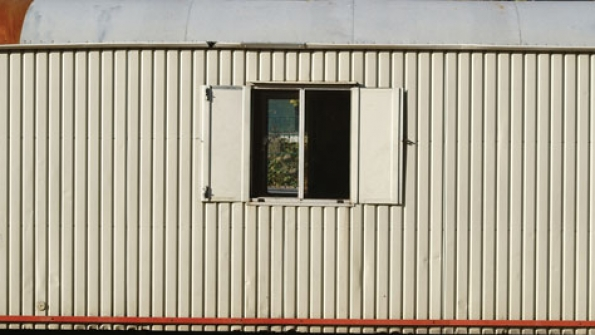

Placing a lunch cooler underneath a construction site trailer proved to be a deadly decision by a construction worker (ginton/iStock/Thinkstock).

To keep their lunches out of direct contact with the hot sun and weather, workers were in the practice of placing their coolers underneath the construction site trailer.
The accident
The timeline and all evidence suggested that the victim had taken a break during the late morning to get a snack. When his coworkers noticed he had been gone for a while, one of them went to look for him, ultimately finding him lying on his back unresponsive under the trailer.
When the coworker grabbed hold of the victim with one hand and one of the trailer’s leveling jacks with the other, he immediately received an electric shock. Realizing that the area was unsafe, he attempted to turn off the trailer’s electrical supply but was further shocked by the metal breaker box supplying power to the trailer. He then yanked the cord that provided power to the trailer hard enough to pull the wire free from the connector plugged into the temporary power box. He was then able to pull the man out from under the trailer. Police and emergency medical support were called. Unfortunately, the victim could not be saved and was declared dead on scene.

As there was an obvious electrical problem on-site, all temporary power was shut down. The initial investigation determined that the grounding connection on the cable feeding temporary power to the site had never been completed. As a result, the whole site lacked any ground connection. Bonding was intact between all metal surfaces such that all metal surfaces were connected electrically but lacked any form of ground protection. (This was the first ingredient of the lethal cocktail).
Upon establishing a proper ground to the site and attempting to bring temporary power online, it was then determined that a phase-to-ground fault existed somewhere — this fault created a situation where all metal structures on-site would have been energized to the phase voltage.
Both ingredients of the fatal electrical contact were found to exist, but in this case the situation was far worse than normal. It was not just a ground failure to a single device but a ground failure that made every metal surface an electrocution risk.

Much of the original temporary power system had been placed in underground conduits so as not to create overhead hazards for the many tall vehicles moving on-site. We were told that the underground wiring had been buried to a depth that met local code requirements. During the inspection, the underground conduits were excavated.
While most of the length of conduit was found to have been buried to an acceptable depth, a length of conduit running under a heavy traffic area was found to be just a few inches below the surface. When excavated, the conduit was found to have been crushed. Insulation damage was clearly visible on one of the phase conductors, and a clear fault was observed. It was obvious that during construction, there had been a change in the grading, which brought the conduit close to the surface. Furthermore, heavy machinery passing over the shallow conduit had obviously crushed the conduit and caused the fault. (This was the second ingredient in the lethal cocktail.)
