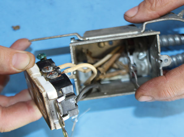

At first, we were frustrated, scanning a sea of char made up of burned tables, rugs, chairs, and other combustibles. Nothing of value that might help our investigation appeared to be there — until we noticed two grounding-type receptacles in the room. The fire damage centered preferentially around one of these outlets.
Photo 2. Green ground screw has no wire attached to it, nor is there a ground wire running back to the condo unit’s panelboard. Note: The green screw was loosened by the authors. Visually, it showed no prior use (i.e., we were the first people to screw it open to accept a wire). You can also see a bare wire connecting the receptacle box to the metal cable jacket. This is a good bond, but the bare wire is NOT in the cable jacket — only a black and white wire run through the cable jacket (i.e., hot and neutral).
Upon closer examination of this receptacle, we noticed it was fed by a 2-wire cable — an ungrounded conductor (i.e., hot wire) and the neutral conductor. Both the black/white wires (hot/neutral) were connected to the receptacle when we examined them (Photo 2). A ground wire was not seen anywhere in the cable jacket, though we did find a bare jumper wire between the outlet box and the metal cable jacket. The ground screw (green screw) on the receptacle was tight — as if it had just come from the electrical supply house. Prior to photographing it, we loosened the green screw and examined it for damage. With no wire ever connected to the green screw, the outlet presented the homeowner a ground pin that was never connected to anything.
It is well known that the NEC requires a ground wire to be present where a grounding-type receptacle is installed. What we found was a clear violation of NEC requirements. Why was their no ground wire connected to this grounding-type receptacle? Did it burn up in the fire? Was it never there in the first place? A quick check of the second grounding-type receptacle in the room revealed the same situation. All of the condo units in the complex were eventually found to be in the same state.
Note: During some of our investigations, we have found that installers will run a small jumper wire from the ground screw on the receptacle to a ground screw in the metal outlet box. The assumption is made that the metal box provides a good ground. This is not true. In the best case, the metal box does connect to a system ground via a ground wire that runs back to the panelboard. In the worst case, the metal box has absolutely no connection to ground. For all practical purposes, this creates an open circuit between the box and ground.
