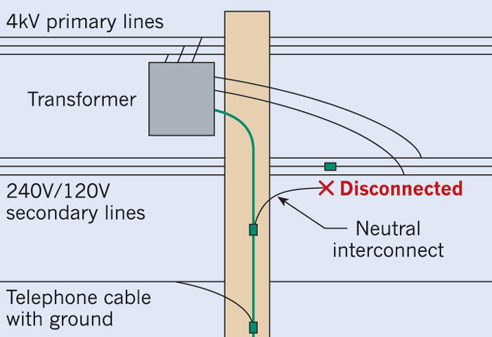

The subject pole featured a power transformer, 4kV primary lines, 240/120V secondary lines, and telephone lines. The pole grounding system played a pivotal role in the accident, so it’s important to understand the design. The electric utility provided a “pole ground” conductor, which ran the length of the pole into a ground rod at its base. The transformer case ground, secondary neutral, and phone system ground all connected to the pole ground. Figure 1 shows the pole grounding system as it was designed. However, not all things were as they should be on the pole at the time of the accident.

There was also a second, more serious problem. The interconnect jumper from the power system neutral conductor to the pole ground was disconnected from the clamp on the neutral conductor for reasons unknown (Fig. 2).
Fig. 2. Modified diagram that shows that the interconnect jumper from the power system neutral conductor to the pole ground was disconnected from the clamp on the neutral conductor for reasons unknown.

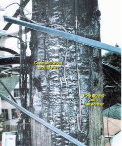

At approximately the level where the phone system ground was clamped to the pole ground, there was evidence of a small fire, and the conductors had melted — opening the connection to the phone system ground as well as the pole ground below it. The only ground connection from the transformer had been through the communication cable messenger wire, which is not designed to carry power system ground current. The conductor or clamp most likely melted open at some previous time due to the excessive current.
As a result of all of the above, the section of pole ground from the burned area to the point where it was cut near the bottom of the pole was completely disconnected and electrically dead. The phone system ground was disconnected from the pole ground. The power line neutral was disconnected from the pole ground (see Photo 1, Photo 2, and Photo 3).
Photo 1. The accident area on the pole shows evidence of a small fire.
The transformer ground conductor ran down to the area of the pole where the fire occurred, but was unconnected at that location. Without a ground connection, this conductor was energized at a high voltage as it carried ground current from the primary system of the transformer. When the victim wrapped his arm around the pole, he made contact with this conductor, which delivered the electric shock.
