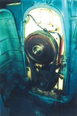

Photo 1. This photo shows the malfunctioning milling machine with the back cover removed.
The accident

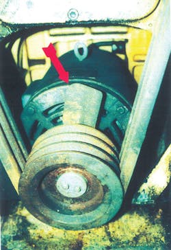

To begin the troubleshooting process, the back cover of the machine was removed, exposing the motor and pulley arrangement (Photo 1). Technician #1 checked his test equipment, while Technician #2 crouched down at the rear of the machine. The machine motor was running, as was a fan blade located in front of the motor on the same shaft (Photo 2). The fan blade (indicated by a red arrow) was not easily noticed because it was spinning rapidly. In addition, its diameter was only 1 in. larger than the diameter of the motor, making it difficult to distinguish from the main unit.
When Technician #2 reached toward the motor with his right hand — in an effort to feel how hot the metal casing was — he experienced what he believed was an electric shock. Instinctively, he jerked his hand sideways. This movement caused his sleeve and wrist to become caught in the in-going nip point of the pulley and pulley belt, which severed his hand.
Photo 2. Here, the motor fan blade is indicated by the red arrow.

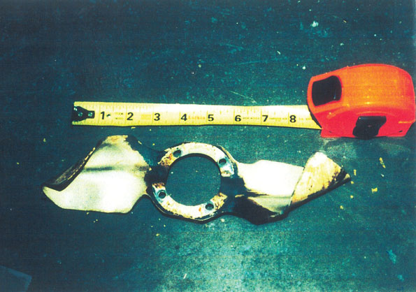

Shortly thereafter, the vice president of the facility arrived on-site and found the finger on the floor. Because it was neatly severed (rather than torn or pulled off), this suggested what Technician #2 had initially perceived as an electric shock was, in all probability, the moment at which the fan blade (Photo 3) sliced off his finger. This hypothesis was further corroborated by the bent fan blade, which was later removed from the machine (Photo 3).
Photo 3. This image shows the bent fan blade that severed Technician #2’s right index finger. Initially, the technician mistakenly believed he had experienced an electric shock.
