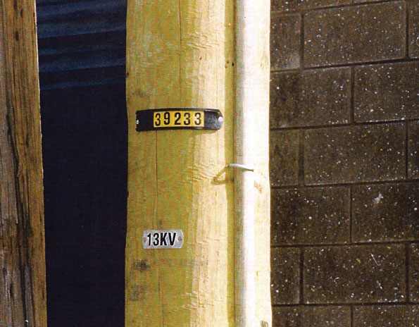

Photo 1. The voltage level of the utility distribution line involved in this accident was 13kV.

The crew performed this installation near a 3-phase, 13kV electrical distribution line supported by a wood pole (Photo 1 and Photo 2). This job was nearly complete — only one piece (approximately 1 ft sq) remained to be set, when suddenly, out of nowhere, a bolt of electricity from the nearby electric line arced over and electrocuted the man in the bucket. Immediately rushing to his aid, the second victim (coworker on the roof) was also shocked and later hospitalized but managed to survive.

We were hired by the insurance company representing the landlord and tenant of the building. First, we checked whether the power lines were located too close to the building in question. The law of the city in which these accidents occurred dictated a certain minimum clearance between a current-carrying conductor and buildings, depending on the voltage of the conductor. In this case, that was 8 ft, 10 in. ANSI guidelines for the minimum distance in this case was 10 ft; the same distance is cited in (OSHA references 29CFR 1910.333(c) (3) and 29CFR 1926.550 (a)(15) and Handbook of Electrical Safety in the Workplace).
Next, we determined that the victim was riding in an electrically uninsulated bucket, which was stationed less than 7 ft from the 13kV line conductors (3-phase). Ultimately, the truck served as an electrical path to ground. The truck was supported by metal outriggers that were separated from the roadway by wood planking. Because the victim was working too close to the live wire, once an electric current arced over to his bucket, a sufficient amount of current flowed through him, the boom truck body, outriggers, and wood blocks to ground. Proof that the outrigger, which sat on a wood block, conducted electricity was evidenced by the presence of a burn pattern beneath its location on the ground (Photo 4).

Based on the investigation and analysis, we concluded that the power company should have obeyed the specification of the city code (8 ft, 10 in.) or ANSI/OSHA/NFPA (10 ft) when installing the utility line near the building. But what we found even more interesting was that the power company had an internal code which required 7.5 ft — even this code was violated in this accident considering the fact that the first power wire was just under 7 ft from the building.
