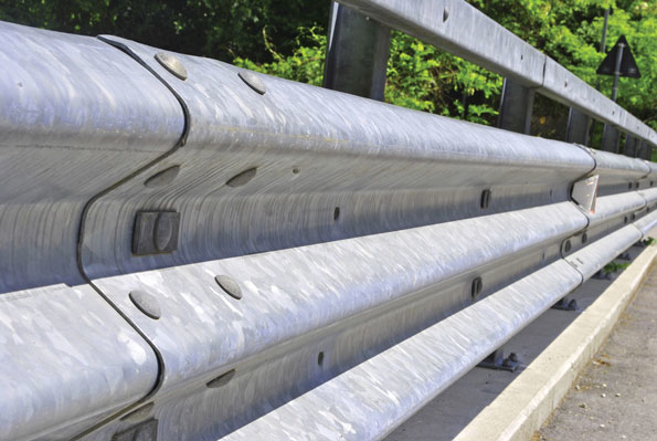

When he was finished, he walked over to an area where a guardrail stood adjacent to a signpost to do some cleanup. As he leaned over the railing, his stomach came to rest on the guardrail. With his left hand, he pushed against the guardrail to stabilize himself. To gain more stability, he pushed his right hand against the adjacent signpost. It was then that he received the electric shock. Immediately, his right arm snapped back from the point of contact. Although he did not fall to the ground, he recognized this sensation as an electric shock and knew he’d been injured. He had no visible electrical burns on either hand — the only marks were red streaks where his stomach had contacted the guardrail.

After the incident was reported, an inspection of the site revealed that when the guardrail had been placed, a conduit containing power conductors serving a lighting load had been breached. This energized the guardrail to 277V. As a result, touching the guardrail was no different than touching an exposed wire. The nearby signpost provided an excellent return path to ground. Presumably, the victim did not receive a shock when he first contacted the rail because his shoes provided adequate insulation, preventing current flow from his contact with the rail to ground. The victim brought suit against multiple defendants, including the fencing company, the construction company, and the electrical contractor.
