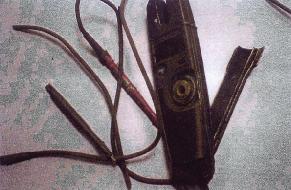

Photo 1. Multimeter is rated for measuring 1,000V, and it is blackened (burnt) as a result of measuring close to 4,000V (phase-to-phase).

Once inside the high-voltage closet, he put one lead of a 1,000V-rated multimeter on one bus bar and the second on another — at which time a tremendous electric current immediately traveled down the leads and incinerated the meter (Photo 1). As a result, the victim received severe third-degree burns over a large portion of his body, including his chest, stomach, arms, face, and back. Despite his serious burns, the victim managed to stumble back upstairs where his coworkers saw him. They administered in-house first aid within a few minutes, and he was in an ambulance heading to the hospital within 12 minutes.

He testified he was measuring the phase-to-phase voltage. This is the wrong protocol for troubleshooting a 3-phase circuit. The phase-to-phase voltage is generally not significant in the original trace of a troubled 3-phase circuit. The proper protocol when measuring an unknown phase voltage in a 3-phase system is to place the ground or common lead of the multimeter on the nearest ground point and then clip the hot lead of the meter to one of the bus bars. Had the plaintiff done this, there would most likely have been no accident, or there would have only been damage to the multimeter. In this case, the phase-to-ground voltage was 2,300V, while the phase-to-phase voltage was almost 4,000V.

Based on our investigation, we determined with a reasonable degree of engineering certainty that this accident involved gross negligence on the part of the plaintiff. We maintained that he was ultimately responsible for the accident because he did not behave in a professional manner or follow the proper protocols, including:
• He did not obtain the available wiring information.
• He did not have approval to work in that part of the facility.
• He did not read the signs that were on the subject cabinet.
• He did not de-energize the circuit he was investigating.
• He did not follow proper troubleshooting protocol of measuring the phase-to-ground voltage rather than the phase-to-phase voltage.
We also found gross negligence on the part of the outside contractor, who completed the retrofit at the warehouse, for not providing proper signage for the subject cabinet. Furthermore, this contractor failed to ensure that the electrical interlock of the incident cabinet was in place and functioning properly.
