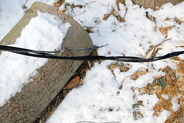

Photo 1. View of the service drop cable showing the severed neutral conductor.
Although it was determined that the fire originated in the master bedroom at the head of the bed, the exact cause was not determined. The remains of a duplex receptacle, electric blanket, and radio in the area of origin were examined. However, extensive damage did not indicate a failure that could have caused the fire.
Examination indicated that the service drop cable to the residence had a severed neutral, as shown on Photo 1. The failure of the neutral conductor appeared to be caused by deterioration due to age and possible contact with tree limbs. Examination of the coaxial cable indicated melted insulation on a bend (Photo 2), indicative of heat caused by current flowing through the shield.

Documents produced during the lawsuit included depositions from the lineman and cable TV technician. The lineman testified that he was dispatched to the house for a flickering light problem. He was aware that such circumstances could be caused by a severed neutral conductor and — if he had seen any breaks in the wire — he would have de-energized the service cable until repairs were made. This action would have prevented the fire. However, he arrived after dark and — although he saw deterioration of the cable — he did not see any breaks in the neutral.
The cable technician testified that when he measured the voltage on the coax shield, he got readings of 20V to 35V, which was not normal. He called his supervisor to discuss the situation and was told to remove the ground connection. After removing this connection, the voltage measurement increased to 200V on the shield. Realizing this created an even bigger problem, he reconnected the ground and again called his supervisor. After another discussion, the technician was directed to cut the coax (although the reason for this action was not provided).
Theoretically, electrical current flows through all bonding and grounding connections to return to the electric utility transformer. The lower the resistance path, the more current will flow. The neutral conductor in the service drop cable provides the lowest resistive path to the transformer. When the neutral wire in the service drop cable was severed, electrical current sought other paths to return to the transformer. Those paths included the ground, through ground rods and a water pipe, and the cable shield that was bonded to the neutral on the electric utility pole where the transformer was located. Current flowing through the shield created heat that caused melting of the jacket. Losing the neutral also eliminated the 0V reference so that voltage on one line conductor increased while voltage on the other line conductor decreased. This resulted in the dimming and brightening of lights.

The lineman was aware of the dimming light problem and that it could indicate a problem with the neutral, but he did not investigate further since the service drop cable was owned by the homeowner. Although he saw deterioration of the cable, he testified that if he had visually identified a severed neutral conductor he would have de-energized the transformer until cable repairs were made, which would have prevented the fire.
The cable technician testified he was aware that lights dimming and a melted jacket on the coax were indications of electrical problems. Furthermore, measurements indicating voltage on the cable shield also indicated an electrical problem. Therefore, he should have told the homeowner to call an electrician. If he had done so without cutting the coaxial cable, the fire would not have occurred. It was also noted that the cable technician violated OSHA requirements by cutting the coax (i.e. working on energized equipment without wearing personal protective equipment).
