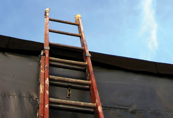

Even a short fall from a ladder can result in a life-changing injury.
The accident
After receiving verbal permission by phone from the owner, the employee turned on the lights for the electrician, who proceeded to climb his ladder to test the connections on the lights at the weatherhead on the roof. Once he finished testing, the electrician began to climb down the ladder. As he descended, something unexpected happened. Touching his hand to the metal frame of the fluorescent sign, he received a shock — despite the fact that his ladder was made of fiberglass. This unexpected jolt caused him to lose balance and fall approximately 6 ft to the ground.
Although the effect of the shock was negligible — there were no visible signs of burning or any inconsistencies in the behavior of his heart or nerves upon medical evaluation — the way in which the victim fell caused severe fractures in both of his legs. Approximately 15 min. after the accident, EMTs arrived at the scene and administered drugs to help the electrician cope with the extreme pain. After medical evaluation, it was later determined that the fractures would never heal properly, requiring the 30-year-old victim to walk with a cane for the rest of his life.

There was one other piece of evidence that struck us as potentially contradictory regarding the plaintiff’s deposition. Why were there no burns whatsoever on the electrician’s hand? Could it be that the alleged “shock” the electrician felt was, in actuality, just the irritation of hitting the sharp edge of the sign? We wanted to investigate the sign and all of its wiring further. We also wanted to test the electrician’s fiberglass ladder, which supposedly would not have permitted an electric shock as described in the testimony. Unfortunately, after five years, the site of the accident was completely remediated. The ladder could not be found; it was presumed to have been sold, along with a great deal of the electrician’s equipment approximately three years after the accident. By the time we were brought into the case, the electrician was back working for a large electrical contractor in a physically passive role that involved supervising others on a job site. Therefore, he no longer had a need for the equipment he once owned as an independent electrician.

We argued for the defendant that these requirements and others similar to them would place the burden of enforcement on the professional — the master electrician — not on the owner. We also did a study on fiberglass ladders that demonstrated how they could break down and conduct electricity if they were neglected. This latter testing was submitted as evidence in the trial, but it was deemed inadmissible due to the fact that the actual ladder used on-site the day of the accident was not available.
