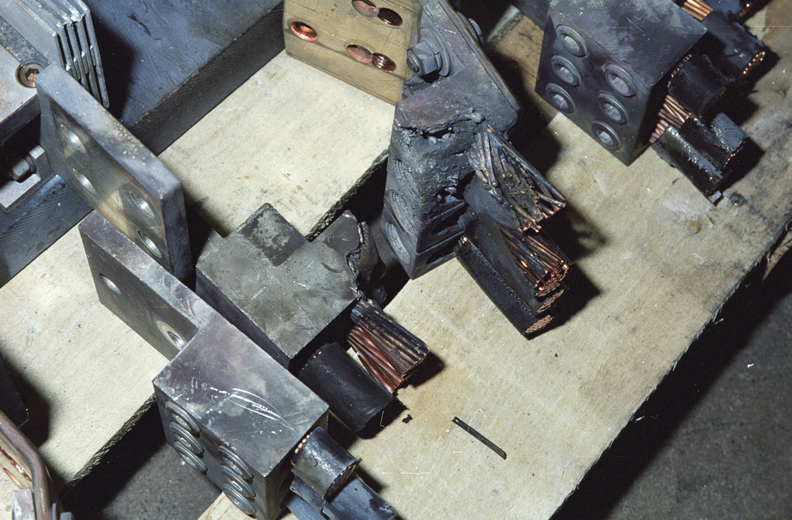

Electrically, the arc blast created severe problems for the packaging facility. Molten metal ejected from the arcing event damaged the feeder connections and conductors at the output of the switch. This apparently created a secondary phase-to-phase arcing event between the left and center phases (Photo 3). This arcing event apparently caused an overload on the utility transformer, resulting in one of the phases shorting out. The facility was left without power until the electric utility could replace the transformer.
The building owner hired a different electrical contractor to replace the damaged switchgear and feeder conductors. This new contractor replaced the feeder conductors and connections. Its employees also allegedly cleaned the switch and put it back into service. Along with the replaced transformer, the electrical system operated properly for the next few days. However, the switch began tripping about a week later, so workers at the plant braced the switch arm closed with a piece of 2x4 lumber.
Finally, a third electrical contractor was hired to replace the switch entirely. This contractor took possession of the damaged switch (Photo 4) and the original damaged feeder connections. Anderson Engineering was then able to examine the damaged switch and conductors at its facility, where we discovered the aforementioned arcing event damage.

The ensuing inspection showed the switch arm was actually broken. Although it's unknown how this occurred, we believe this possibly happened when the switch attempted to trip while being held closed — or it may have been stressed from multiple actuation attempts.
Although the switchgear was damaged by the arcing event, the switch was most likely suffering from a mechanical failure when the original electrical contractor attempted to close it. In this case, the switch may not have been maintained properly. Manufacturers typically require a regular cleaning and maintenance schedule to keep their equipment operating properly. This could include replacing or polishing the contact plates, as well as lubricating the switch mechanism and the plates themselves. This switch should also be actuated on a regular basis and checked for signs of abnormal resistive heating, among other necessary performance tests.
The arcing event caused further problems as well. Although the switch appeared to sustain little physical damage, it should not have been put back into service. If the bolted switch plate connections are not tight (and do not have low resistance throughout), hot spots can develop at the higher resistance areas. High-resistance heating can melt the switch plates, permanently damaging the switch, and possibly even weld the contact plates together, preventing the switch from opening if a downstream fault occurs.
