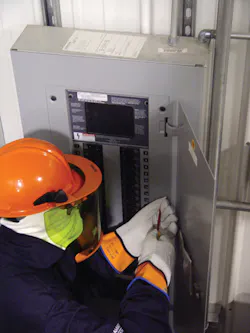

The 2012 revisions also seek to increase the margin of safety afforded by PPE in some scenarios. Of particular note, a requirement for hearing protection (ear canal inserts) within the arc flash boundary has been spelled out, and a balaclava is now required for Category 2 tasks defined in the HRC tables, a result of the removal of the distinct 2* category that required a balaclava as a supplement to a hard hat and face shield. Larry Ayer, vice president of Biz Com Electric, Cincinnati, and a technical committee member, rates that change as significant in that it’s evidence of 70E’s steadily greater recognition of the need for proper and adequate PPE.
“The balaclava now applies in more instances, even for less hazardous tasks,” he says. “The committee was concerned that Category 2 PPE requirements left the back of the head exposed. So a contractor can’t just put on a face shield in those situations. As a contractor, the way I see it is the more protection, the better.”
