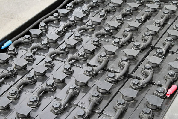

The global market for Li-ion batteries for EVs is expected to grow to 61.3 GWh by 2020. As these batteries will not be suitable for EV motive use after a 20% loss of their capacity, this results in a significant number of used batteries containing a large portion of their capacity intact (Maxvis/iStock/Thinkstock).
