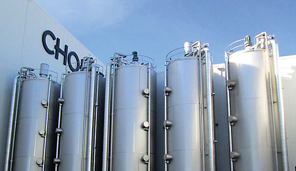

The new Twin Falls, Idaho, Chobani plant features several 32,000-gal yogurt process tanks.
Since 2007, Chobani’s brand has grown so quickly that it couldn’t produce enough Greek yogurt out of its New York plant to keep the store shelves full. To add more capacity, the company added a second yogurt processing facility in Idaho. The entire manufacturing process — from milk receiving to the creation of yogurt and packaging of the product — occurs under one roof at the new plant, which sits on about 200 acres.
