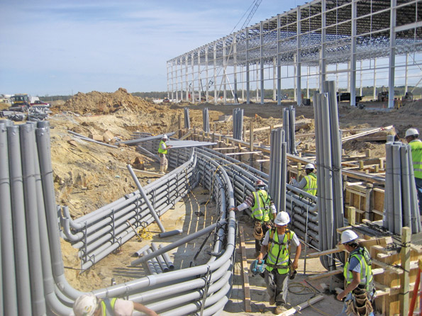

Multiple electrical power feeders serve the main electrical room.
