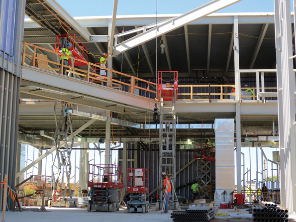

Using lifts and fall protection equipment, workers construct the natural history museum.
