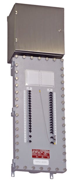

This hybrid version of the XP circuit breaker panelboard incorporates a factory-sealed cast explosionproof enclosure (CEC/NEC technology) to house arcing breakers and a stainless steel terminal enclosure (IEC technology) for field terminations
March 8, 2010
This hybrid version of the XP circuit breaker panelboard incorporates a factory-sealed cast explosionproof enclosure (CEC/NEC technology) to house arcing breakers and a stainless steel terminal enclosure (IEC technology) for field terminations. Available in voltage configurations of 120/240VAC, 120/208VAC, 277/480VAC, or 347/600VAC, the product is rated for the Class I, Division 2, Groups B, C, D; and Class I, Zone 1 and 2; and AEx de/Ex de IIB + H2, T6. Other third party approvals include NEMA/EEMAC: 3, 4, 4X, 7BCD, 9EFG, 12; and IP66. According to the company, conduit or cable entries can be created on-site by using a sheet steel hole punch.
