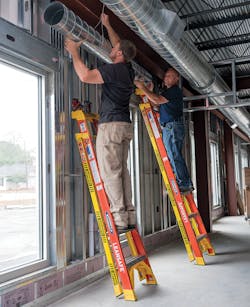

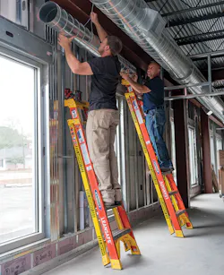

This year’s first place runner-up comes from the tools (equipment) category. The LEANSAFE step ladder from Werner Co. is designed to be safely leaned against walls, corners, studs, or a pole. Features include a Type 1A Duty Rating and a load capacity of up to 300 lb. Constructed of 7-layer fiberglass, the OSHA- and ANSI-compliant product is safe to use when working around electricity and comes in a variety of sizes ranging from 4 ft to 12 ft in height.

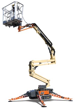

From the construction equipment category, this year’s second place runner-up is JLG Industries’ X430AJ compact crawler boom, which offers a horizontal reach of 21 ft - 7 in. and a 500-lb unrestricted platform capacity. With a stowed width of 2 ft - 5 in., the boom easily moves through doorways, gates, and yards. Additionally, the machine can be transported by forklift or crane, thanks to its forklift pockets and lifting eyes. Other features include an Li-ion 2.0 power system for eco-friendly operation indoors or outdoors, a tracked wheel carriage that climbs ramps, non-marking tracks for use on sensitive flooring and landscape applications, and auto-leveling outriggers for added stability when working on slopes or uneven ground.
