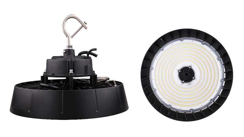

The product incorporates networked lighting controls for increased energy-savings potential.
Suitable for use in warehouses, manufacturing facilities, auditoriums, and gymnasiums, the UFO LED Highbay with Networked Lighting Controls from EarthTronics delivers maximum lighting efficiency for 15-ft to 25-ft mounting heights when replacing up to 400W HID luminaires in either the United States or Canada. Featuring a 5,000K CCTwith an 80+ CRI, the luminaires are available in 100W, 150W, 200W, and 240W, providing 14,000 lm to 33,600 lm operating at 140 lm/w. In addition, the DLC Premium, UL/cUL-listed, and RoHS-compliant products offer two electronic driver options: one operating at 100VAC to 277VAC, 50/60Hz, and the other at 100VAC  to 347VAC 50/60Hz (0V to 10V dimming is included with both). Optional accessories include an emergency backup driver, microwave motion sensor, and remote-controlled sensor. Each luminaire is designed to accept a “twist-on” full-featured sensor that allows for occupancy sensing as well as daylight harvesting and dim to off functions. Also standard is a 12VDC power supply for operating optional network lighting controls.
