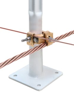

The Super-Clamp GXP1828RF grounding clamp accepts a wide range of pedestal types as well as conductors
April 18, 2011
The Super-Clamp GXP1828RF grounding clamp accepts a wide range of pedestal types as well as conductors. The accepted pedestal range includes ¾ in. through 2 in. for use with round and square styles (7/8 in. to 2 in. round and ¾ in. to 1½ in. square). Featuring a wire range from No. 6 solid to 4/0 stranded, the wires can be arranged in parallel or in a cross grid configuration and can accept one or two wires. In addition, the cULus-listed clamp can be installed using ½-in. socket type tools, including a nut driver, drill (cordless/corded), traditional socket set, and open-ended or adjustable wrenches.
