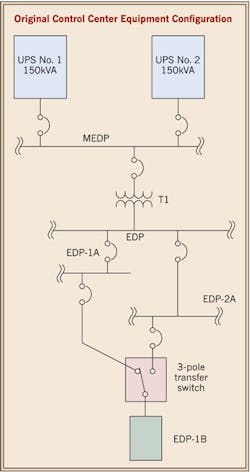

Fig. 1. Partial one-line diagram of the original layout.

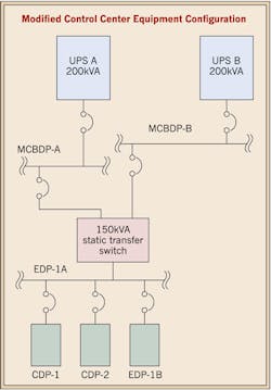

The utility’s original control center included two 150kVA/120kW UPS units (with 480VAC outputs) configured as a parallel redundant system (Fig. 1). The system was replaced by two 200kVA/200kW modular UPS systems and a 150kVA STS with a reconfigured distribution wiring system. With the new system, UPS System ‘A’ feeds ‘A’ power supplies while UPS System ‘B’ feeds ‘B’ power supplies in the dual power supply IT equipment arrangement. All single-corded equipment is powered by the STS (Fig. 2).
Fig. 2. Partial one-line diagram of the completed upgrade configuration.

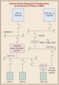

At the conclusion of Phase 1, UPS System ‘A’ and the STS were factory started and commissioned. But, as the contractor continued to add more new panelboards, “High Output Ground Current” alarms began occurring on the STS (Fig. 3). At this point, a service call was placed to the STS manufacturer. It recommended the ground sensing circuit be calibrated, and dispatched a technician under a warranty service call.

Fig. 3. Partial one-line diagram of system after completion of Phase 1 work.

Our firm’s first step was to understand the installation as it was configured at the end of Phase 1. Where in the system were bonding jumpers installed and N-G bonds required, and were there any in the system that were not allowed? After a detailed site walk-through inspection and review of the drawings, it was determined the only place in the existing installation that an N-G bond would be allowed was at the STS.
The STS uses two isolation transformers, one for each source, to step down the 480V input from the UPS systems to 208/120V for distribution. The transformer arrangement would make the STS a separately derived system, per the NEC. A system bonding jumper (i.e., N-G bond) would be required at this location per Sec. 250.30. This is the only separately derived source in this section of the distribution system; therefore, no panels downstream of the STS should have bonding jumpers.

Before the installation of the parallel 150kVA UPS systems, the existing installation used a 3-pole transfer switch to feed panel EDP-1B, which supported telephone operations. This provided redundant power sources for the telephone system. Source one of the transfer switch was from EDP-1A and source 2 from EDP-2A. Both panel EDP-1A and EDP-2A were fed from the parallel UPS systems output wiring arrangement during a previous upgrade (Fig. 1 on page 14).
Panels EDP-1A and EDP-2A were existing panels, and their neutrals were bonded to the neutral lugs in the transfer switch. With the re-feed of panel EDP-1A from the new STS, the parallel paths were from different sources. For current to return to the source of EDP-1A, current on the neutral conductor of EDP-2A could only return on the equipment ground conductor (see Fig. 4 for details).

It was recommended the STS be removed from service as the new infrastructure already provided redundant sources of UPS power to panel EDP-1B. An alternate option would have been to install a 4-pole transfer switch to prevent parallel paths for current on the neutral wire and comply with the NEC. The owner decided the transfer switch was not needed, and removed it from service.
