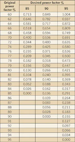

Now that you have this number, you can refer to a PF correction table (Table 1). Looking at the Table, go in from the left with the existing PF, and then come down from the top with the desired PF. Where the two lines intersect, you'll find the multiplier you need. Take that multiplier and multiply the motor's input kW by it. This will give you the required kVAR of correction.
Finally, using the data in Table 2, select a capacitor, rounding down to the next lower value. You now have the correct size capacitor for your PF correction plan. For a typical installation, see Calculation Procedure Example.

Step 4: Find multiplier to get desired PF correction
In our case, we want to correct the PF from 85% to 95%. Looking at Table 1 and going down the 95% column and across the 85% column, we see that the intersection is at 0.291, which is the multiplier we need.
Step 5: Multiply input kW by multiplier
The calculation is 78.8 × 0.291 = 22.9 kVAR.
Step 6: Select closest kVAR value
Using Table 2, we see that closest value rounded down is 22.5 kVAR.
