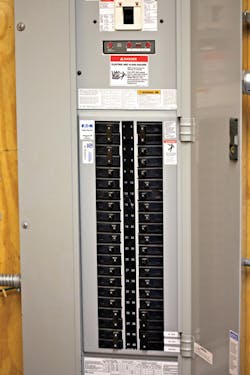

Overcurrent protection of conductors is an idea so simple that it is almost self-evident. Excessive current in a conductor results in rapid temperature rise, which damages insulation and creates enough heat to ignite nearby combustible material. Therefore, if you limit the current to a manageable level, you’ll protect the conductor and any materials nearby.
You can achieve this in one of two ways:
1) Insert a short segment of material of lesser ampacity (e.g., a fuse) in the circuit path, which would melt and open the circuit path before more widespread damage could occur, or
2) Incorporate a mechanical device into the circuit (e.g., a circuit breaker) that would perform the same protective function, but that could be reset any number of times rather than being replaced.
Fuses provide perfectly competent overcurrent protection. However, in residential and other low-power applications, they are considered obsolete, though still Code-compliant. Besides being resettable, a circuit breaker provides a clear visible indicator when it has switched off after detecting a fault. In addition, these types of panelboards are easier to wire and repair.

Breakers should be exercised (turned off and on) periodically. Trade practice is for breakers to be exercised once per year, regardless of size. Where there is no excessive dust or humidity, this interval may be extended to once every three years, but the procedure is so easy that you might as well do it once a year. This is particularly true in the larger sizes, and it should be part of the preventive maintenance program in any large facility. If properly maintained, breakers last a long time. However, some workers intentionally shunt a branch circuit in order to trip the breaker. This is a very poor maintenance practice, because it stresses the contacts and shortens the life of the breaker.
If large aluminum conductors are terminated at a circuit breaker, then the lugs need to be retorqued periodically. A loose connection where heavy current is present will inevitably heat up.
