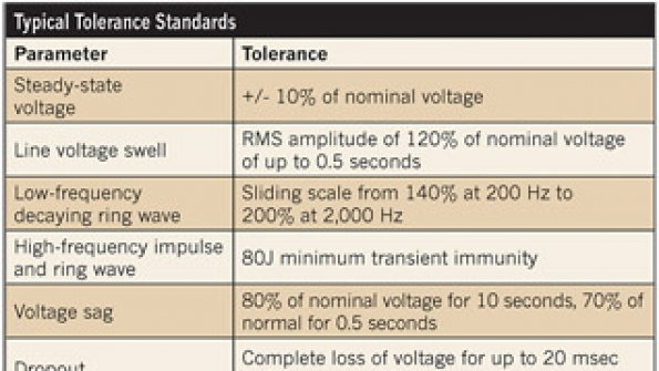

Some testers come with pre-loaded monitoring standards based on the most widely used international voltage standards, such as CBEMA, ITIC, IEEE 519 or 1159.1. Different applications require different voltage quality standards. Some are quite stringent and will record many events; others are less stringent, applying tolerances designed for modern, more robust loads, resulting in fewer out-of-tolerance events to be recorded (Table). The important thing to note here is that you thoroughly understand how the monitor you're using works and the parameters it's using to make measurements.
