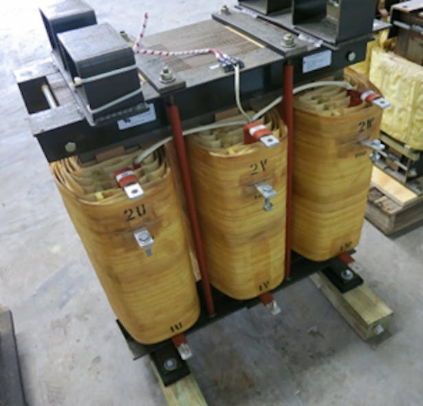

  • Installing line reactors (Fig. 5). This is especially helpful for VFDs, as the current waveform can be smoothed out by increasing the line impedance of the supply circuit, limiting harmonic currents.
Specific transformer configurations can limit certain frequencies. Traditional delta-wye transformers limit 3rd harmonics (180 Hz). A delta-wye-delta configuration (Fig. 4D) can limit 5th and 7th harmonics. A delta zig-zag transformer can limit 5th harmonics.
For example, a line reactor was ordered and installed for the 1,492kW, 4,160V VFD motor at the wastewater plant. Line (and load) reactors are classified by their percent impedance (denoted as percent %Z), which is the voltage drop due to impedance, at the rated current, expressed as a percent of rated voltage. The most common line reactors have either 3% or 5% impedance. Reactors with 3% impedance are usually sufficient for most solid-state applications in North America. They absorb normal line spikes and motor current surges and can prevent most nuisance line tripping of circuit protection devices. AC line reactors help reduce the level of harmonics on the electrical system by effectively expanding out and reducing the peaks caused by a VFD’s inverter (as shown in the Photo).
When higher line disturbances are present, such as the situation described here, 5% impedance reactors may be needed. A higher impedance reactor is generally recommended if an application requires IEEE 519 compliance. If the aim is to diminish noise from the motor or to extend motor life, higher impedance reactors can be used to reduce harmonics even further. This additional performance typically comes at a higher cost than 3% impedance versions (due to system losses). But when multiple motors are controlled by a single drive, a single load reactor can be placed between the VFD and the motors, simplifying the system layout and reducing cost.
