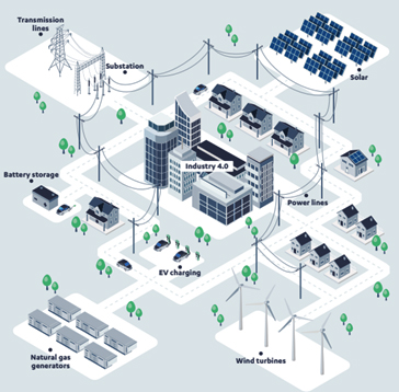

The power grid is ever-evolving (Fig. 1). Wind, solar, battery electric storage systems (BESSs), EV chargers, etc., all contribute to the deep penetration of high-frequency switched power electronics, leading to the inevitable increase in the levels of supraharmonics with possible negative consequences on the grid.

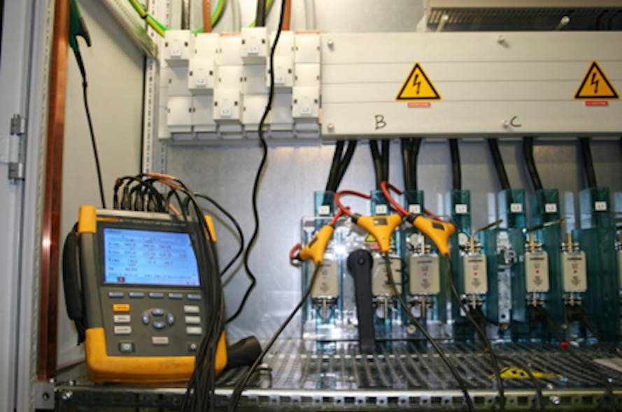

The long-term effect of supraharmonics isn’t fully understood, as research is limited to date. In addition, many traditional measurement tools are not able to measure these higher frequencies. Higher-end power quality meters (Fig. 2) can measure up to 10 kHz for low-voltage systems (<600VAC). Technology for measurements of high-frequency harmonics on medium-voltage cables and equipment lags behind.

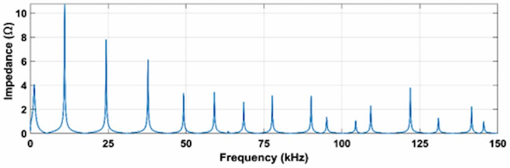

A recent study of wind farms in Sweden noted visible supraharmonics up top 150 kHz (Fig. 3) from Evaluation of Medium Voltage Network for Propagation of Supraharmonics Resonance, Department of Engineering Sciences and Mathematics, Luleå University of Technology, Sweden.
